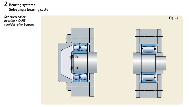

I would have expected the motor end play to be equal to or only slightly more than the internal clearance of the spherical roller bearing, the mounting of this bearing should provide very little end play of the outer race. Thermal growth of the motor should be taken care of by the plane roller bearing.
Your motor bearing arrangement arrangement is similar to this one.
Picture from SKF motor handbook available from here
I agree. I see no reason to have as much float in this shaft, even though the motor overhaul shop says it is nothing to worry about.

The bearing on the right on the above picture is how the current d.e. bearing sits in the end cover of the motor, with a spacer ring
and a retainer cap on front and back, except it is a spherical roller bearing of course. Instead of being captured in place, it has this extra float. It is a tapered bore bearing sitting on a sleeve with a lock nut.
Wait, what? It requires special set of tools for mounting and dismounting and internal clearance measurement etc.
Wonder that's why the DE bearing keeps failing and not because of lack of greasing.
