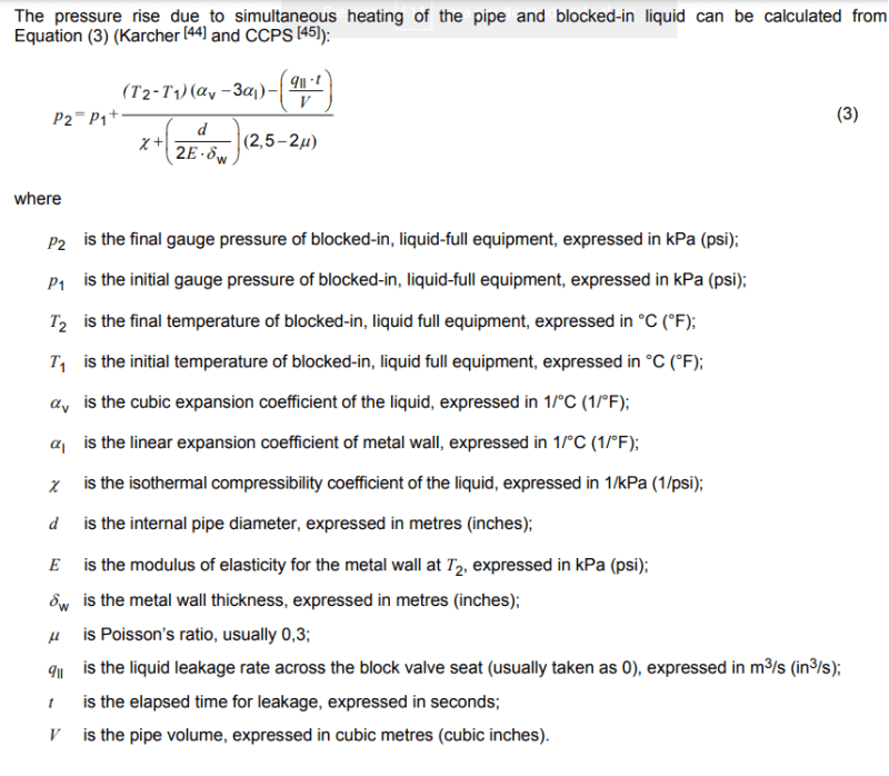

We are analysing the need for relief valves in a system completely filled with a blocked-in fluid with internal pressure rise due to thermal expansion resulted from heating by solar radiation.
By consulting CYRIL F. PARRY – RELIEF SYSTEMS HANDBOOK and API 521, we found general orientations regarding the maximum volume recommended without the need for relief valves, depending on how dangerous the fluid is (0.01 m³ for those considered high risk, and 100 m³ for those that do not represent risks).
However, we are looking for ways to find especific values of lenght (or volume), depending on the amount of pressure rising due to termal expansion of the liquid, but we cannot seem to find any.
Is there an equation that correlates ΔP suffered by the fluid and the L (or V) of the tube so we could express our conclusion with something as simples as "every L meters you will need to install a relief valve"? Which criteria of tube lenght per diameter (volume, m³) can we use to determine where the relief valves should be applied?
API 521 has an equation for pressure rise due to blocked in thermal expansion.
If a compressible liquid is trapped and heated, it will expand and it can/will break things if there's no provisions to relieve pressure/divert flow.
You mean this one?
But we would have to know the time for leakage, which we don't. Is there a way we can calculate or estimate a reasonable time?
@shvet, hes asking for the distance between PRV's.
@KFCeng, assume leakage is zero that would be worst case.

This question arises a lot during design of plants etc and AFAIK, there are no formula or calculations I've ever seen, only company guidelines and procedures from the bigger companies or design houses or in design books like you quote. There is no real science behind it.
It is a mixture of practicality and cost to arrive at any length where you can say you don't need pressure relief. What that is seems to vary widely.
For me anything over 5m should have one, but sometimes you see this expressed in volume. The reality is that as pressure rises, valves leak / pass, flanges weep, seals pass and you often only need a small volume to greatly affect pressure.
I can remember walking around a fuel manifold in the sun thinking there was a leak, but the guages were all rigid at 100 bar and it was all the thermal reliefs gently hissing into the closed drain system.
Each to their own seems to be the rule, but remember pressure rise can be 2 to 4 bar per degree C rise. So start at a low pressure in a high pressure class system and you might be ok. Reverse and you won't. See this FAQ So if you can show that at your start temp and pressure and your final solar temp which is rarely reached, especially on larger lines, and you are within your design pressure then you are ok. But if not then you are at risk of exceeding your design pressure.
But also remember that any system which expands and relieves through a valve can then cool and go into vacuum / vapour generation mode....
Also remember some liquids expand a lot like LNG and LPG where you get huge volume changes.
You can never get this right. Too few and damage / leaks and potentially rupture can occur in locked in sections or they become difficult to open under high DP. Too many and everyone complains about the cost and the small bore drain pipes and maintenance costs increase.
You make your best guess during design. Then after startup and during operations, you tweak it.

TRVs are required for any blocked in volumes where heat input can result in pressure rise beyond piping design pressure, no matter what the blocked in volume is - for piping. I dont know of such requirements for tubing.
ExxonMobil's std. XVC said:
6.12.3 Application of Liquid Thermal Expansion Protection
Short sections of piping less than 100 ft (30 m) in length but not exceeding 250 gallons (900 l) in volume which can be blocked in, generally do not need thermal relief valves.
Shell's DEP 80.45.10.11 said:
3.10.4 Piping
2. Piping that can be blocked in and contains more than 500 L of LPG or “very toxic” liquids require a TERV. For processes that have a low threshold on material releases (e.g. environmental reporting of ethylene oxide releases), more stringent criteria than what is shown above may be appropriate.
