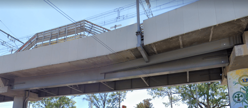

So, it would be either fatigue crack at the tension flange, or buckling of the entire beam.
Beams seem well aligned after collapse, so presumably the former?
To help aggrivate matters, from the photo, it appears that the spandrel was discontinuous in the vicinity of the failure to accommodate a light standard of some kind.
Quite likely, hokie... just added dead load... it looked substantial enough that it would provide some stiffness and a marked discontinuity. At about 0.6 span...
That connection of the divergent beam at the mid span I don't think is coincidental.
It looks quite strange, the main beam is the same size, it's a point load in the middle of the span and appears to rest on the bottom flange only.

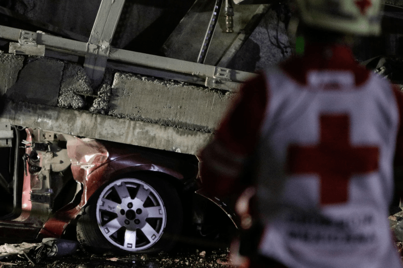

What is striking to me is how cleanly both of the girders are fractured, suggesting fatigue failures of both girders? Is it possible that both girder bottom flanges were substantially cracked through without being noticed at any point?
If it were only one girder which had a crack through the bottom flange, I would have expected one of the girders to maybe fail in fracture, and the other to fail in a more ductile manner. But this does not appear to have happened.
I wonder how often these bridges were inspected?

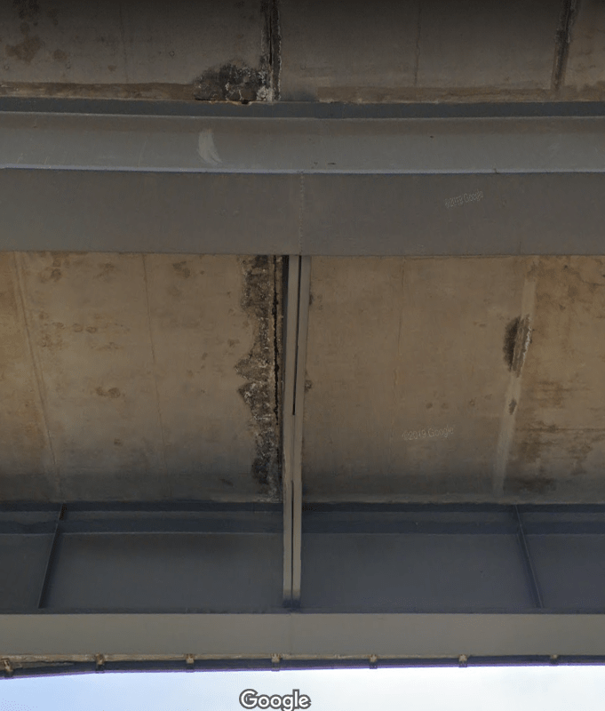

Agree with the previous poster that the precast decks were probably intended to be made composite by grouting a shear stud into a recess and also grouting between the deck units. This would explain the narrower top flanges. But there appears to be cracks between the adjacent panels, which might suggest that there was less (or no) composite action than anticipated and the bottom flange was working much harder than designed for (leading to fatigue cracks through the flanges at the butt welds).
Is there a chance the steel may not have been weldable? or maybe poor low hydrogen welds?
Yes, a material failure, either in the base metal or the weld metal, could be at issue.
But I keep going back to the small top flange. While the concept of developing composite action sounds attractive, the reality of introducing enough shear connection between a narrow flange and those precast deck units is questionable. That would require a lot of connectors, I think in a single line, so the deck units over the beam would have to be like Swiss cheese. And then the joints between the panels have to be grouted, leaving no gaps, at least over the beams.
And as gusmurr said, if composite action is not achieved, the bottom flanges would have to work too hard.
Same picture as tomfh, but there's something odd about that truss. It's the only one which is not in line with the lines of the slabs above. It actually looks slightly bent but I thought that was google street view being not precise.
Did it get "shifted" so they could repair the gap in the concrete above it?
The column set up also changes at this point to move over for a three track layout vs 2 track leading to a bit of instability in the column forces.
That flared beam coming in does appear suspicious. It would add a mid-span reaction to the exterior girder, and also the load is eccentric to the web centre-line, adding a torsion to the main girder as well. At the same time, the same simple cross frame is located on the back-side as exists along the span.
