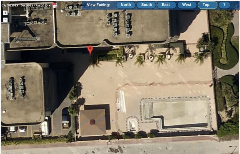

Miami-Dade Pictometery,
another county aerial photo site, not the same as DB27 cited. This one has views from top and N, E, S, W oblique views back to 2007. Place marker initially shows on building to the south because it is in the way of North facing view. Top view location OK.
If you look at the Dec 2012–April 2013 slice, you can see the pool tile being renovated.

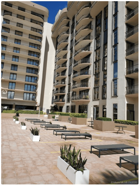

I noticed something that may be somewhat of a clue, on one of the real estate listings on Apartments.com from a few months ago. Link

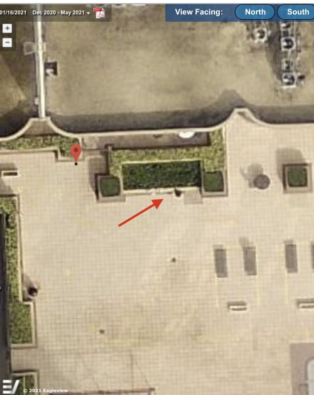

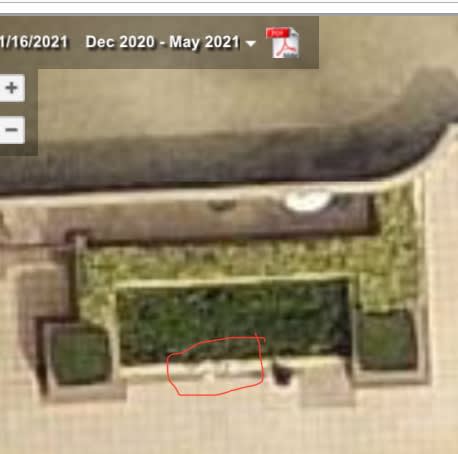

Specifically, there are some pictures taken of the pool deck area. (See pictures 18 & 19 from the top on the above link). Right next to one of the planters, near/above parking spot 78, I see a temporary barricade (see below). What kind of damage was that barricade covering? The watermark on these pictures seems to imply that they were taken around November 2020.

Checking the aerials around that date, it looks like there may actually be a hole in the slab at that location.

Added 2-Jul: image source is Miami Dade Pictometry top view:
Original:

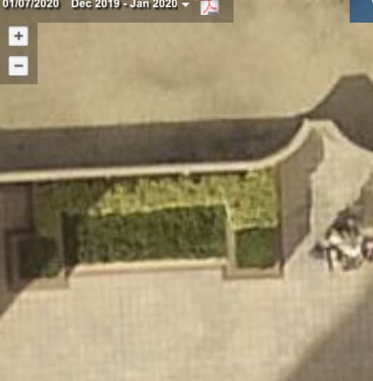

Ref the temporary barricade cited by Roga50 1-Jul-21 3:45; a square feature, a black feature and changes (damage?) to the planter border appears adjacent to one of the planters in image of 16-Jan-21
vs no such features appear in the earlier image taken 7-Jan-20 below
My parents had a small fire in a lot not far from them. The fire department pulled the water main pressure down and triggers the alarms on adjacent buildings.

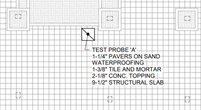

If the drawings are correct. That looks like the location of the test probe.
The “curb” like feature between the planter boxes looks chewed up in the Jan-21 picture, it looked fine in Jan-20.

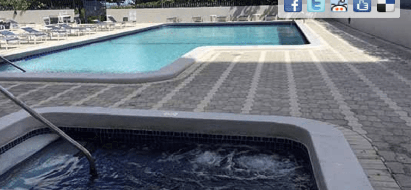

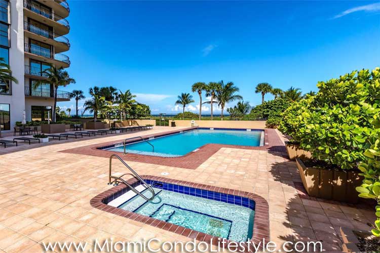

I found this photo of the North Tower pool area. The pavers appear to be the original “keystone” pavers specified on the original finish schedule. Note the lower elevation of the pavers relative to the edge of the pool, then compare to the present day South Tower pavers which were flush with the pool edge. Combined with the test probe callout, I think it may be that the South Tower slab had perhaps double the superimposed dead load that the North Tower has.
North:
South:
The other aspect that jumped out at me is that the waterproofing layer in the test probe was found ABOVE the original paver layer. That suggests waterproofing was added decades after construction, as part of the new paver renovation.
