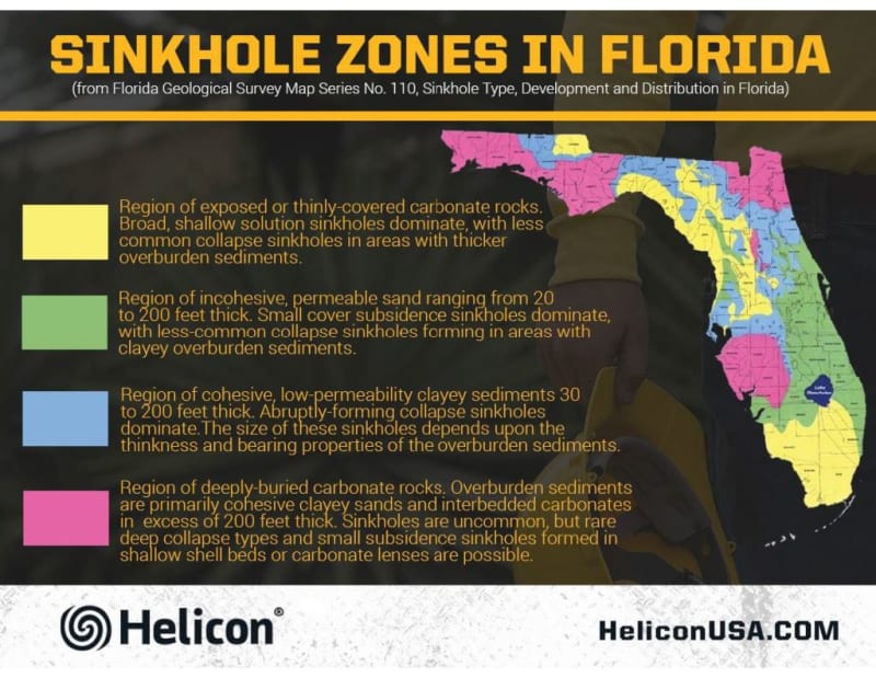

Couldn't it also just be caused by a sinkhole under the foundation? If the concrete was leaking water down to the garage from the pool deck too, it seems likely that the foundation was doing the same.. perhaps that caused some damage? It was above limestone. It seems very odd to me that this column collapsed onto it's side, but the column next to it puncture sheered and there's nothing that shows that the pool deck was pulling the collapsed column towards the southwest. It looks like the pool deck just fell straight down.
I found this map which seems to say that it's possible.

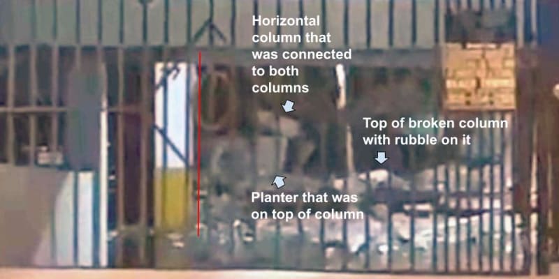

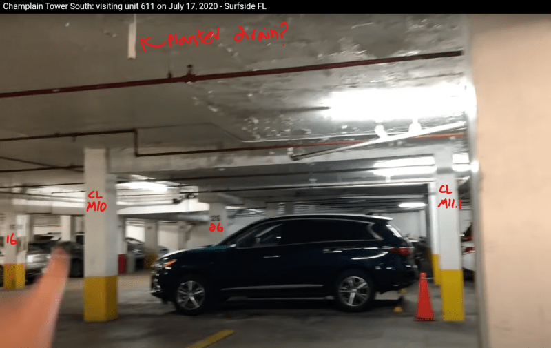

Column M11 should be about where the word “both” in your graphic appears.
I pointed to the wrong beam in my last post. I went back and checked the video again and it was actually the next column line to the east, which was closer to the core drill. Also saw what looked to be a planter drain.
Note the Column at M11.1 is quite smaller in cross section, possibly 12" x 16" - much more susceptible to a vehicular impact. But if that's what happened, the only way we will ever find out is through surveillance video or a confession.
The thing that's nagging in my mind is the column on the left (M10) is supporting the building and the column on the right (M11.1) is only supporting plaza slab. But since they are connection by a beam, if the column on the right (M11.1) collapsed for some reason, the falling slab would cause the beam to rotate clockwise and put a huge bending moment on the left column (M10). That's a plausible trigger for the subsequent building collapse.

Js5180, I agree with you? Although, it wouldn't be quite at that word and closer to the 'th' in 'both.' If we're looking at the top of that column in that pic, it's easy to see where the bottom would be if it weren't covered in rubble. It looks like it's still all in one piece.
bones206, Interesting, I hadn't noticed that pipe but it does seem like that could be right under the planters in front of 111.

What production model car is going to gather enough energy to dislodge that column with at most, 85ft of run-up space on slick concrete from a dead stop? The garage entrance gate was closed too, and those things don't just slam shut. No car took out that column, unless both theories are correct, and a car fell off the penthouse roof onto the pool deck.
Anyone else notice that M11.1 is super thin right at the top? There is a beam between M10 and M11.1, but the beam is sitting on a real skinny bit of M11.1 column right?
Per the drainage plans, that would indeed be where a 2" planter box drain is called out.

That’s just a trick of the light. The column isn’t skinnier at the top.
Column M11.1 failure doesn’t have to be the initiating event. That beam could have simply failed at mid span and it would have had the same effect of applying a bending moment on column M10.
