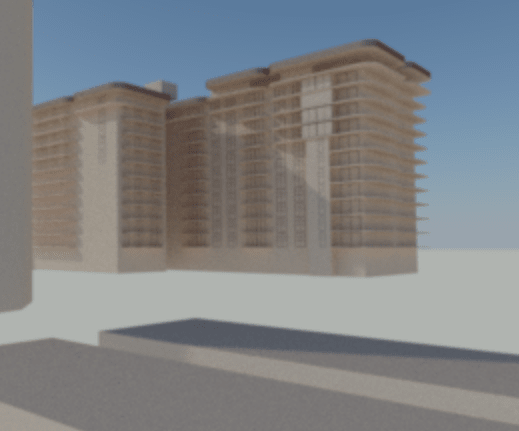

For those looking for grassy knolls in blurry videos...
This is how the building would have looked from the camera's precise perspective, when intact.
...something's not right about the balconies with concrete (is this what we are calling parapets?) instead of wrought iron railings...See above at:
