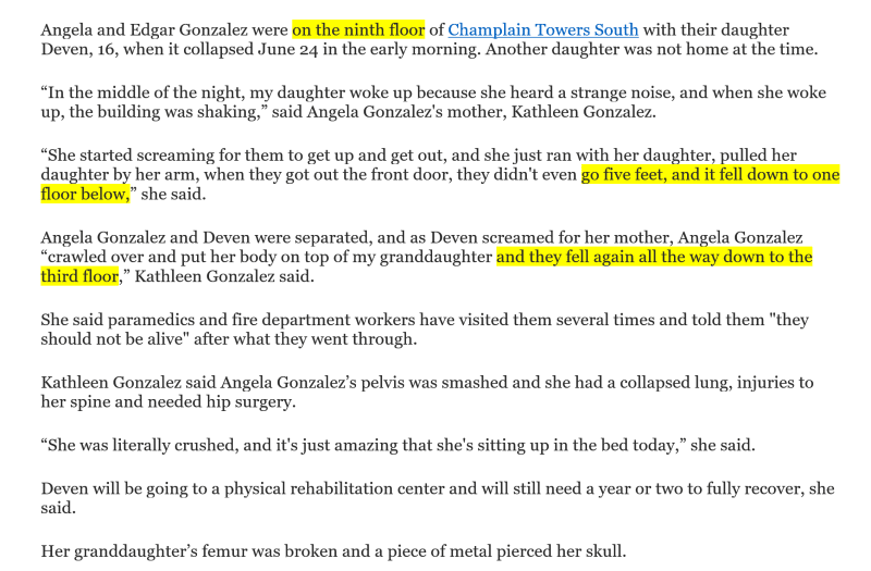

arbitraria (Civil/Environmental) said:
I wonder if the front door to 811 was compressed by the failure that woke up the camera one story below them?
After watching the 711 video, the idea that the front doors may have gotten wedged and prevented people from escaping is one of the two things about the collapse that keeps me up at night (the other being that the eastern stairs led nowhere safe). Just curious, does anyone know what kind of doors they were? I think steel doors are required in NYC, and my friend's door is robust. I can run through most non-steel doors... but to escape their unit, it would be easier to rip a hole through the drywall.
BKNJ
Demented
Quote (Vance Wiley)
I do not know if the framing is the same as regards columns and slab reinforcing. They did intend to reduce the concrete strength above some level - perhaps the 8th floor?
"-1kPSI concrete for 9, 10, 11, 12, 13 from lower levels."
^ This could explain the brief pause at the 8th floor?
BKNJ
They got out the front door.
If they had run straight (doors face south) ahead instead of turning left...
