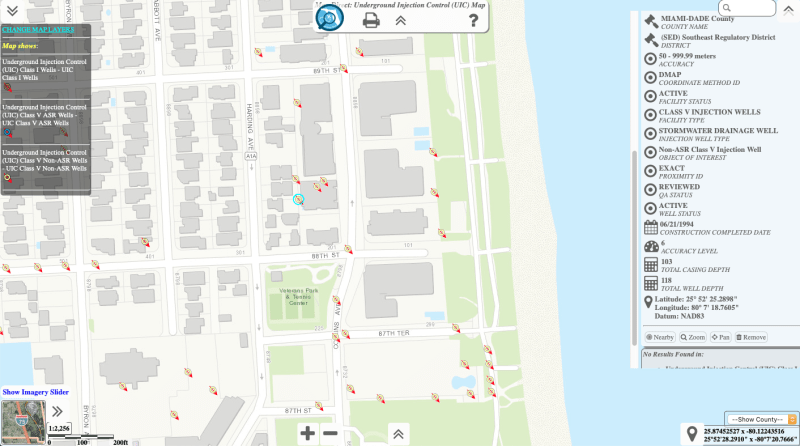

raymiepo (Computer)13 Aug 21 16:50 For those interested in info about CTS injection well > Interactive map for: Underground Injection Control (UIC) Class V Non-ASR Wells (ASR) Aquifer Storage and Recovery. [URL unfurl="true" said:
https://ca.dep.state.fl.us/mapdirect/?focus=uic[/URL]
A couple of things I've discovered:
1. CTEast has two wells.
2. Mirage on the Ocean, 8925 Collins Ave, has one for stormwater drainage with a construction complete date of 01/13/1982.
3. Surf Club, 9011 Collins Ave, has one for swimming pool drainage with a construction complete date of 06/07/1977.
4. CTSouth and CTNorth have none showing on the map.
5. Wells, in the area, are around 80 to 90 ft. deep.]
Very Interesting. I notice on your link that 87 Terrace has no less than 12 wells surrounding their property. One or two are listed in Surfside but most are listed in Miami. Point being 87 Terrace has the ability to shed a lot of water fast compared to anything in Surfside area.
I checked and the articles do say CTS Developer contributed $200K towards Sewer improvements and not storm water drainage. The deepest well I saw around CTS and 87 Terrace was 136 Feet
Edit: Collins Ave has 4 wells between 88th and 87th along the front of CTS. So a lot of water is being dumped deep underground on two sides of CTS.
Edit2: The 3 Collins Ave Wells in front of CTS were drilled in 1994.

for what it's worth, a lot of those wells for 87 Park were for dewatering.
@raymiepo,
Looking at the storm drainage link you provided, the Four (4) 2016 wells along the East Beach Side of 87 Park are De-Watering wells, 1 of the other drainage wells is a 1984 Vintage Well, and the other 7 are 2017 Vintage Drainage Wells.

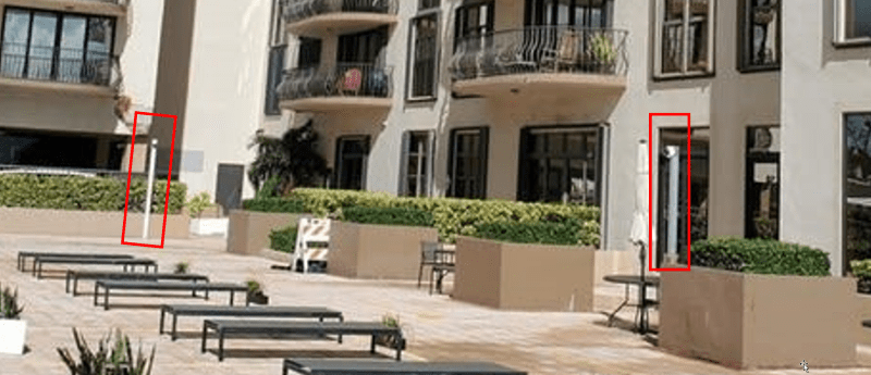

Just found two more security cameras on the pool deck. Unlike the two cameras found by Kreemerz in Part 2, which appeared to look south directly over the pool area and east to see people approaching the gate to the pool area, these two cameras appear to look south over the pool deck between the pool and the parking area and east to see people approaching the doors to the stairwell and the gym room. Both of these latter cameras should be positioned to see any collapse of the pool deck and provide a time stamp, with the latter camera also being able to see if the collapse started on its own or as a result of an object dropping from the roof onto the patio area outside room 111, under which the objects in the TikTok video were seen. If the tapes from these two cameras are not made available to investigators, and eventually to the public, then the absence of these tapes would need a good explanation.

fyi:
clicked on the "?" (Help Documents and Contact Information)at the top center panel of the link.
I shot an email to the GIS.Librarian. Asked how far back the data/information dates.
Got a very quick response by a very cordial Training Lead at the Help Desk. Response included that the layers on that map represent all the UIC Wells in Florida so there isn't really a date range set for the map.
so my focus of interest remains:
Did CTS ever have permitted, inspected, and recorded wells as drawn on the plans?
Where/into what did the 18" storm for CTS discharge?
Does CTN have permitted, inspected, and recorded wells?

raymiepo, I too would like your questions answered. It appears CTS N and S might have gotten a pass on storm water system. You are the first to really research this area. We know the site did not drain well, so it appears the water just sat on top of roof and patio slab? We know storm drainage pipes were replaced in garage a couple of years ago with PVC, and cast iron may have been in real bad shape. Plus I have read the plants had root snakes up to 12 foot long in the drainage pipes.
It could be there is a 3000 gallon tank underground but perhaps the well was never installed? The Collins Street Wells were done by FDOT in 1994, I think. Or perhaps CTS was tied into some sort of Surfside Storm Drainage System in 1981, that was abandoned when FDOT updated Collins Ave? But that does not mesh with the 18" pipe thru the east wall of the tub.

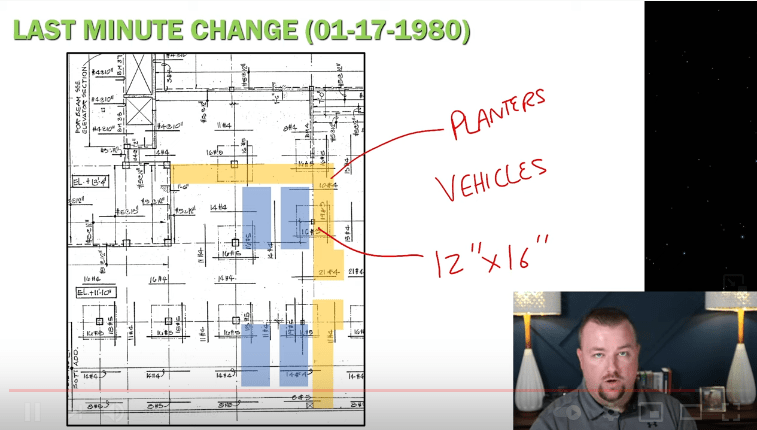

Nukeman948 (Electrical) 14 Aug 21 01:39 said:
As I stated earlier... He does a fine job of laying it out.
And to carry on, the pool deck collapse, initiated at the car park, was retarded by the stiffening offered by the beams and slab steps as it reached the 11.1 grid line ... for maybe 5 minutes or so.

Solid analysis by Building Integrity. Would like to learn more about his calculations showing that the pool deck was designed at 100% capacity with dead load, and whether that considered additional loading from the topping layer, sand layer, and pavers, along with planter beds containing water saturated soils. His identification of the two 12"x16" columns at the edge of parking as a weak link, makes complete sense as a likely origin of the failure.
14,000sqft of the pool deck was not as originally built. So the loading on it was actually far worse.
