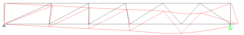

Meerkat007, your comparison between bridge collapse movie and theoretical simulation of truss without member #11 looks similar. It tells that the diagonal #11 crumbles at the base first, otherwise, it would have pushed out #12 a great distance based on the geometry as shown below, before the base slab tore away from #11 and #12.

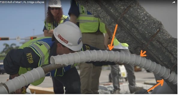

Please forgive me if I missed this in skimming the previous threads but:
-I noticed the PT sheath that I assume is from member 11 is nearly intact. I would think it would be destroyed as it ripped out.
-Maybe the old eyes missed it but if the PT strand was within the ties of member 11, I would expect to see the broken tie ends projecting where the PT rod ripped them apart. Was the PT rod a late addition outside the ties when it was discovered that the transporter needed moved inward and member 11 became a tension member (temporarily)?

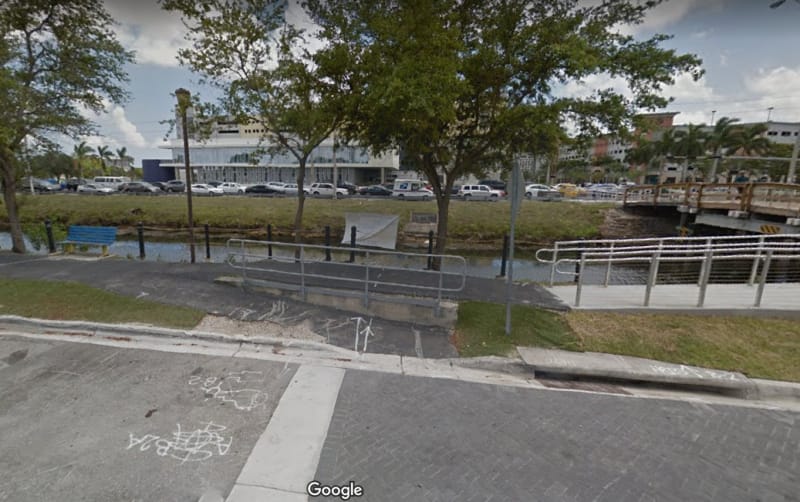

Correct me if I'm wrong but with the pylon moved 11 feet further to the north, this part of the bridge was 186 feet (57.2m) long instead of 175 feet.
FDOT reasonably distances itself from this project because Florida International University received Local Authority Program (LAP) Certification to oversee the project. Link
FIU installed Smart Bridge Technology on a new flyover from eastbound State Road 836 to northbound State Road 826 in Miami back in 2013, why they didn't do so here is frustrating. Link
The City of Sweetwater really has no roll in this project. They transferred title of the land to FIU at an inflated price of $1.3 or $1.6 million and agreed to participate in a shuttle transportation program, requiring they provide a "refurbished" 10+ passenger bus. When the bridge was moved from one side of 107th St. to the other, they agreed to assume the costs of completing the remaining improvements to the existing "historic" pedestrian bridge access. They did it on the cheap. Their approval of the ADA work is laughable.
According to the FDOT LAP guidelines FIU had the responsibility to have the FDOT sign off on the Right-of-Way BEFORE requesting Bids for the project. The delay & redesign fall squarely on their shoulders. TY Lin seems to have been providing Planning Services since 2014 for the global "University City" plan. Should they have been prompting FIU to the ROW requirement? Or did FIU just bite off more than it could chew.
