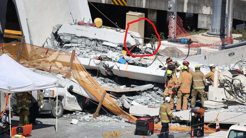

VSL employee was tied off to horizontal safety line. The safety system became wrapped around the exposed post tension rod. See attached photos. This unfortunate worker seems to have been flung by this while bridge fell. It looks like he dangled from crane because vertical crane line held up the horizontal safety line.
The north end fell fast in part because the center of gravity falls at 1 g, but like a falling smoke stack, the free end goes faster. The marks on the pylon made by the falling deck may help with investigation. The marks begin well below the top of pylon base.
The central web truss does not look right, it looks more like a concrete canopy support system would look in a walkway/plaza on solid ground, not a support system for a 174 foot span. It looks like they were going for clear vistas from sides of walkway, so they put only one web in the middle. It's sad, but FIU/MCM put in writing (the proposal) all the constraints that added together doomed this project. I.E. ABC, a pedestrian overpass that resembles a magistic full size cable-stayed bridge, concrete to be cool in summer, wide ribbon deck...
This bridge will not be completed with this design, you can bet the new design will be highly redundant.
I will keep on open mind until report from NTSB is issued, but I must say now, I'm shocked engineers did not block this project and even more shocked rod adjustment was done while traffic was below.
This bridge failed because deck separated from joint 11-12. Half the steel of 11 went with deck, the other half went with 12. Joint burst and beam zippered, no PT-rods or anchors broke. I agree with other posters the north end depended on support from other section that was not yet in place or the stress path was bad. The "last minute" 11 foot increase in span is scary to me.

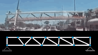

Comparison between bridge collapse movie and theoretical simulation of truss without member #11
Deck fail between member #11 and #12 #10 and #11 is close too.
Courtesy to Zac Doyle for video and to Ivan Markov for online simulator.
Data input : (0, 100)(87, 100)(154, 100)(221, 100)(289, 100)(358, 100)(412, 100)F:(0, 139)(80, 139)(157, 139)(240, 139)(327, 139)R0:(412, 139)(0-1)(1-2)(2-3)(3-4)(4-5)(5-6)(7-8)(8-9)(9-10)(10-11)(11-12)(0-7)(7-1)(1-8)(8-2)(2-9)(9-3)(3-10)(10-4)(4-11)(11-5)(5-12)(12-6)
Meerkat007
Can you set simulator to no connection between deck and 12?
For that simulator is same if you remove deck between #11 and #12 #10.
Delete "(11-12)" from data input.
UPDATE: You can remove member #12 entirely together with canopy.

Meerkat007, the simulation clearly showed the movement of the roller support, akin to the tore out. I am newly registered here, and found this discussion really interesting, with lots of great responses. Thanks a lot.

Meerkat 007, I would rather not have to remove all those elements, need bending resistance. I know Java model cannot do that as is.
