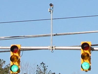

Hopefully when the NTSB releases their preliminary report, they will also release the actual Traffic Cam footage. I don't accept that they failed to record and make a copy of the Traffic Cam footage. Indeed, if they in fact failed to record the incident, then that itself requires an investigation. Shortly after the accident, they shut down the public feed of the traffic cam and have since, removed the cam from the public website menu.
One of my concerns about the report from the NTSB.

jrs87 - This is the best I can supply. When I first checked about a week after the bridge collapse, my recollection is that there were 3 traffic cams on US41 and now there are none. Perhaps they are all part of the same feed network. Maybe there is construction work that has disabled them but why the no longer appear on the traffic cam map is odd.

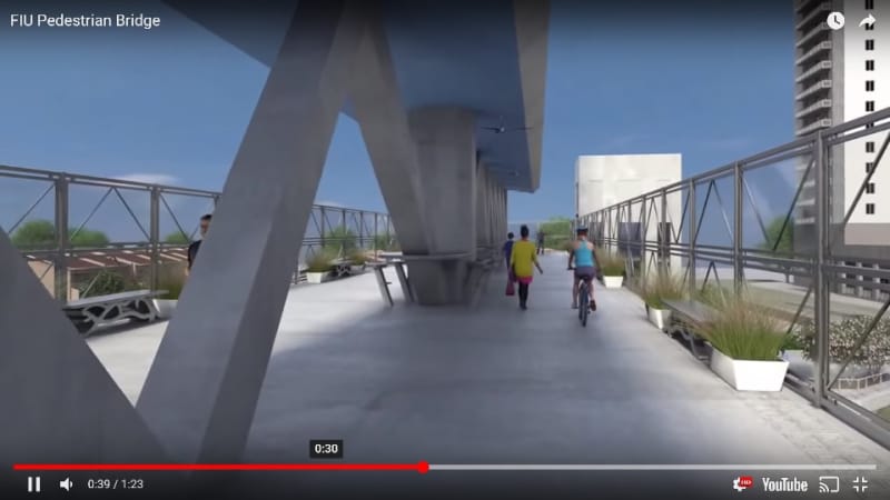

Another possible sign poor judgement was used designing bridge. Several feet of free passage width were to be used for planters, benches, and tables? If so, to use this much width for non-function use is pure folly. We all know any increase in width for a suspended load comes at a non-linear cost. I hope to run numbers to see what a practical width would be for expected foot traffic. Decided not to bother when I discovered stairway on north end was to be less than 11 feet wide and the elevator is small. So they meant it when they said this bridge was to be "floating public space". This is a world-wide growing trend, parks and gardens on rooftops for example.
We may be a victim of our own success. Failure is so rare, people stop realizing danger is there. Building this bridge was dangerous... because building ALL bridges is dangerous.
That is a video camera detector for sensing vehicles in the left turn lane. Video camera detectors are a new sensor technology in use at some traffic signals. These detector systems use digital image processing to detect a change in the image at a specific location in the travel lane due to the presence of a vehicle. Video camera technology potentially allows a wider variety of vehicles to be detected than with inductive loop sensors, but the camera must be properly installed and adjusted for this to work.
Will not have a wide vision and most likely would have not picked up the bridge collapse.
A traffic detection camera
bimr: thanks for confirming that (and 3DDave for the link). In CA they have (old tech) sensors under the pavement to detect traffic/regulate signals. In MO they have these cameras at newer intersections - I'd wondered if they were for red light runners [at a new intersection by my house, after a year the lights were still badly timed.. been in CA 6 months so maybe they programmed them by now].

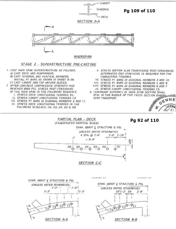

Below is tensioning sequence for mainspan.
The 2/6/18 memo said hairline cracks only in #3 and #10 showed after stressing rods in #2 (on 1/30/18) and #11 (on 1/29/18).
The 2/28/18 memo said bad cracks at base of #11 showed after the formwork was removed - which is what triggered the cracks (cracks happened before repositioning SPMTs, cantilevering span ends, moving the span, etc - which removes most of the ABC concerns of building elsewhere/moving into position). This should have raised red flags since three of four engineers who only saw the photos said it indicated eminent failure. I'd like to know how far the #11/deck crack in Photo 4 extended toward the north end.

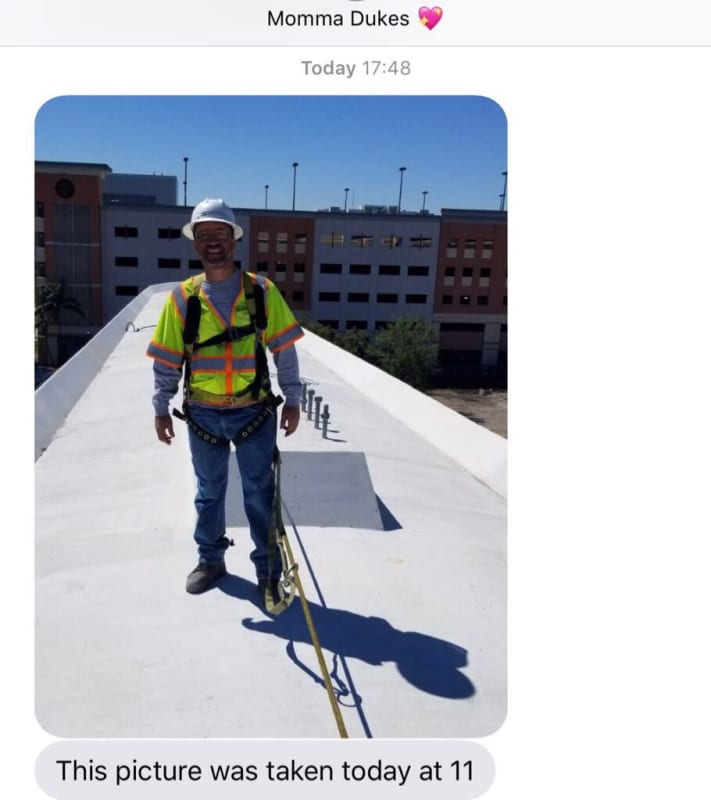

Clear (and blocked) view of blister. Is see nothing remarkable. According to Internet, this photo was taken on day of collapse and this worker was on canopy at time of collapse and survived. I have his full name, but choose not to disclose it at this time. My question is, can anyone here determine markings on hardhat? I'm curious who he worked for. It seems to me three people only does not add up if they were trying to mitigate cracking. Who was monitoring cracking as they changed stress?
I wonder if this is the worker who latched his harness when he heard a crack - I thought he may have been hidden behind the crane with harness suspended from it. Three Structural Technologies workers were there - Mr. Brown, and two went to the hospital, but I never read any more about the third. A couple comments somewhere said no one was watching the cracks, but it'd be logical to do so if rods were tightened to close them (maybe even Denney Pate) - if the road wasn't closed, no one should have thought it hazardous to stand there.

chris snyder said:
"latched his harness when he heard a crack"
Yes, worker in photo is the one reported to latch harness. According to his cousin, he credited it with saving his life.
About the crane operator, he jumped out the crane very quickly and seemed to understandably panic. Media reports he fled scene seem unfair.
