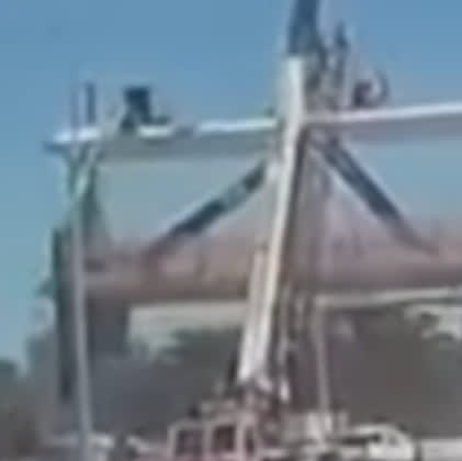

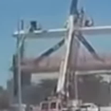

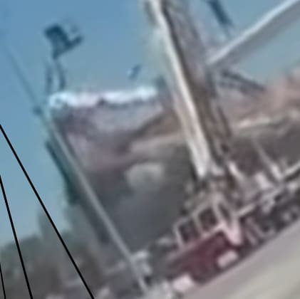

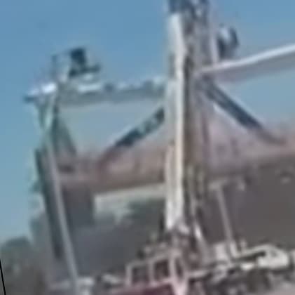

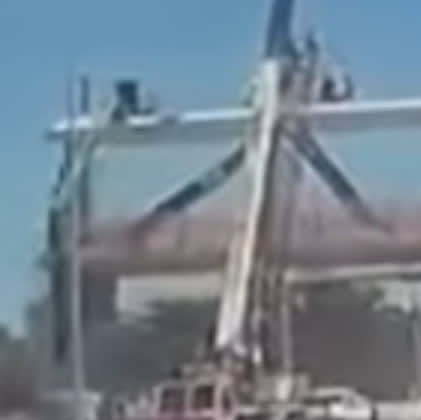

It may be a little late in the game but here is my animation of the collapse based on the dash cam video. I've taken seven screen shots, rotated the images to align the orientation with the canopy section from 11 -12 and then centered them with the white figure on the #11 banner. I've attached a GIMP image file of the seven layers for better clarity of the subtle details.
I believe this shows clearly that #11 ruptured at the base (puff visible in image 2), then the canopy snapped along with the top of #11, then as #11 is pile driven into #12 evacuating a significant amount of concrete from its bottom end , #12 is pulled over and down off of its base by the canopy section which is still attached to the larger canopy by the PT bars (layer 5 and 6). I believe #11 needed to loose about 7 feet of length to straight line with the long canopy. The slab dropping from the pylon does not occur until after this sequence. This also helps to explain why the lower PT bar in #11 is kinked upward at the slab (or sheared per OSHA).

Sym P. le - your "dash cam video" from Joel Franco's YouTube channel is one of many fuzzy interpolated versions. Here is the highest quality version that I've found. You can clearly read the ID number on the school bus bumper: 32082. It appears to be sped up, but this is what the original footage looked like, as I explained in my post of MikeW7 (Electrical) 12 Jul 18 02:16 in Part VIII.
Thanks Mike, I'll see if I can improve on the images. Did you check my GIMP file, the images are much clearer than the GIF. I was more interested in the overlay and reorientation of the images to see if it could give a better understanding of the collapse sequence.
Sym P. le - I just checked your video link and saw that it was a low-quality version (fuzzy, can't make out ID number on bus bumper). The YouTube owner, JoelF (Franco), is some kind of free-lance journalist and he was sent (or obtained) one of the first copies of the dash-cam video. The original source video, as far as I can tell, was obtained directly from the truck driver by a web developer with the handle o2webdev. He posted it on his FB and IG, where some of the local media (Miami Herald, etc.) found it, and he ended up deleting all his social media accounts shortly after that. I got my shortened copy from somebody's FB before they deleted it.

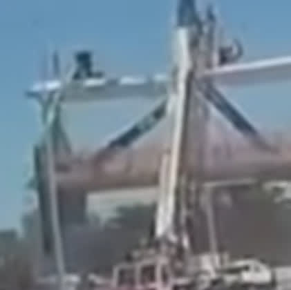

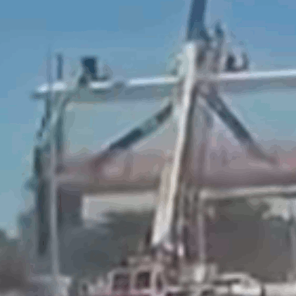

Here are the individual images. They seem blurry (are soft) because the video poster cropped and magnified the video, and this is to our advantage. I'm not sure I can do much better in a short period of time.

Sym P. le - Attached is a 9-frame video, with individual JPGs of each frame. They are cropped to 212x203 (original video was 1280x720).
NOTE: "Zoom, enhance, zoom, enhance" only works in the movies.
UPDATE: I will try again tomorrow. The JPGs I made are distorted...
Sym P. le said:
yet another post based on bogus images
Please please read the previous forum posts about these interpolated videos. You are not analyzing evidence, you are analyzing the model used to interpolate, which means you are muddying the waters by claiming that these images tell us anything useful.
As MikeW7 pointed out 28 Mar 18 22:52, the dashcam video was capturing at 5 frames per second. And read here for how intermediate frames are interpolated, in that case by Zac Doyle:
Note in particular that the frames are interpolated (morphed) by the user manually drawing reference points. A user will generally place the points to show more or less linear motion. The user will not know if some abrupt accelerations, deccelarations, or changes of direction took place in the 200 milliseconds between video frames. The author of that blog post wrote:
"However, as I mention above, there are errors present in the rendering. One consideration you mentioned was the possibility that the motion is being linearly interpolated between the points, as in they move in a straight line from point A to point B. That is absolutely correct in regard to how the motion is interpolated in this. I could correct for a more expected curved motion for the reference points. However, its more challenging to get this correct in the short time I was spending on this."
You may choose to disregard this, others may find it useful. Poor video is better than no video. I chose to present it in a different manner. The movements I've referred to are significant, even in terms of the limited quality of the source. The time span covered is less than 2 seconds, probably closer to 1.4. This is the smoking gun on the collapse sequence. Period.

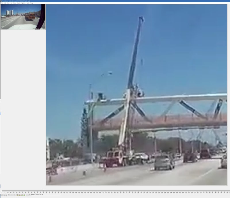

After spending a couple hours this morning trying to figure out how to "properly display" images I've come to the conclusion that it is darn near impossible. Anything that displays an image, be it a viewer or editor or browser, automatically processes the crap out of a small image as it is enlarged to protect you from the embarrassment of seeing square mono-colored pixels in their naked glory. As such, it is very difficult trying to illustrate how difficult it is to "zoom, enhance" a low-resolution video and expect it to provide a divine revelation.
Here's the best I could do. I took the original "high-quality" truck cam video, original format 1280x720, and used VirtualDub2 to crop out a 200x200 image at frame 70. VD2 is one of those rare applications that lets you see something resembling real square pixels in its work window. Then I took a Windows PrintScreen from my 4K monitor and pasted the capture into another of my favorite free apps, IrfanView, cropped the PrintScreen image, and saved it as a JPG with 100% quality:
The result is an 2509x2160 image that preserves most of the original 200x200 video frame chunkiness and allows you to see just how lego-like the video details really are. Note the stair-stepped diagonals.
Next I used the VD2 Rotate2 filter to spin this frame -30 degrees, and did an identical work flow to process a screen capture:
The result is a confusing, blocky mess, but this is what the real raw data looks like. It can be edited to look "cleaner" and "more realistic" but doing so severely damages the true visual data.
In closing, this isn't intended to be a criticism, just a friendly reminder that whenever you work with computers you are plugging into the Matrix, and the onscreen "reality" isn't always what it seems to be.
