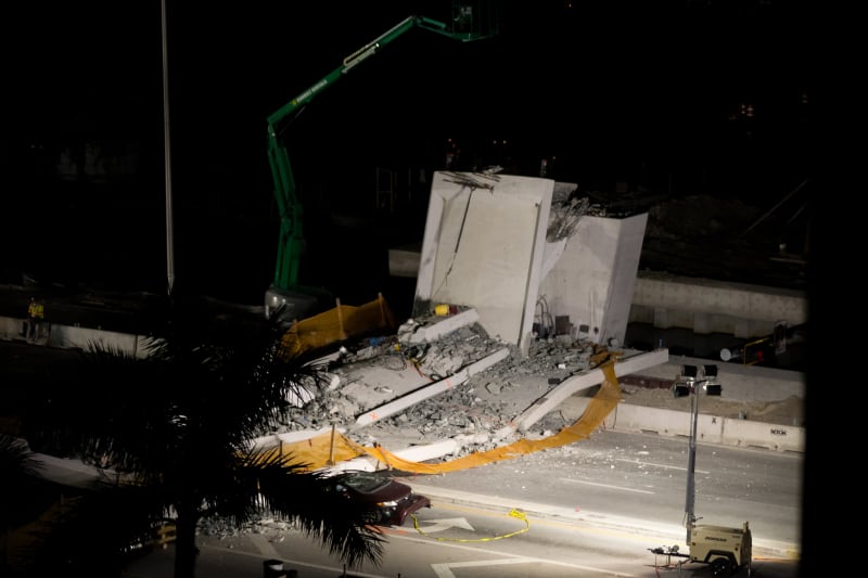

OSHA states the 45 degree influence of PT each side of 11/12 in the deck leaves 11/12 outside the shear lag zone so the horizontal force is not restrained by the PT.
As I recall, "40YearsExperience" was addressing exactly that in his posts, and suggested reinforcing wrapping behind 11/12 and extending into the PT compressed zones.
It think you may be referring to this informative post by SheerForceEng in thread part IV, 24 Mar 2018 22:40, responding to my questions as to whether the diagrams I sketched represented principles we would expect to see in the 11-12-deck connection, conveying the horizontal load of #11 to the deck's longitudinal PT bars.
Skimming the OSHA report, it appears that Figg had intended to join the main span to the back span in such a way as to resist the sort of tear-out failure that caused the collapse. However, I haven't seen any signs of this plan in the materials so far released. Did I miss something? Were they going to connect something to the ends of the longitudinal PT tendons where they came through the diaphragm? I saw one passing reference to this in regards the tendons in the canopy, but if there were references to doing that with the tendons in the deck I missed them.
If this is actually the case, it might explain earlier commentary about "capturing the node." Maybe they were planning to build an appliance that they could attach to the ends of the PT tendons to simulate the presence of the back span and resist tear-out at the 11/12 node.
Another angle. Note large size of concrete chunks.

More concerning is their assertion on one of the photos that #11's lower PT bar sheared off, when photos at the scene show it attached to the deck, which is a highly important piece of evidence implicating the tensioning of this PT bar as the final factor precipitating the collapse.

That "capturing the node" discussion stems from the "cracks" meeting just prior to the collapse. From that meeting: "Steel channels to 10/9 node & PT Bars to capture some of that force which is better than vertical support.". So something like this:
This was deemed "better than vertical support", because just supporting near the end of bridge, does not deal with the horizontal component of #11's compression.

I believe OSHA is correct. Those members were 21" wide
You are so correct - and thank you. I just embarrassed myself bigtime. And I have deleted the post and can only hope you were the only one to notice. In my defense - I was only 90 degrees disoriented, N vs S is 180 degrees. Not a lot to hold onto, but that's all I have at this time.

Regarding the 45 degree shear lag and transferring the horizontal force from 11 to the PT -
I had forgotten the post you reference but I thought a similar post with "V" shaped diagonals wrapping the 11/12 node had been posted by 40YE. Now I see he has apparently removed his posts - I did a search and did not find one. I agree with the reinforcing - but it would take a lot to develop the 1300 kips (DL) and more to be safe for TL.
I too have trouble with that statement.
I have only seen details that anchor the concrete closure between the diaphragms to the pier cap, and a couple of PT rods down into the pier. Also some delayed placement of PT in the canopy to tie the tops together. And the casting of the 109 foot spire to support the fake "strands". Has anyone seen more ties detailed? Anything that could develop 2000 kips?
