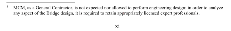

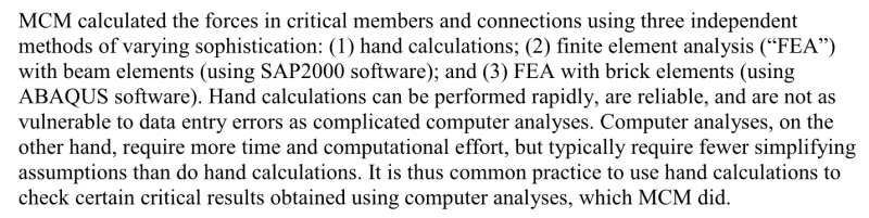

In MCM's post-failure submittal to the NTSB ["MCM Party Submission; Findings, Conclusions, Recommendations, and Attachments"] document #628566, Section 5 "Engineering Analysis and Discussion", MCM present several analysis methods and calculations:
Basically, they compared SAP2000 and ABAQUS to some hand/2D calculations, and noting that they are within 3% of each other.
MCM make a compelling statement:
MCM submittal page 73 said:
As discussed later, the value of 1,710 kips for interface shear at Node 11/12
arrived at by simple hand calculation greatly exceeds the value of 571 kips that FIGG extracted
from its LUSAS finite element model (see Section6.2.1). A hand analysis should have thus
revealed to FIGG that it had greatly underestimated the shear force at this critical connection.
