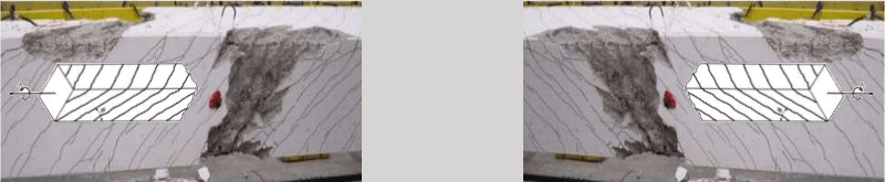

Note to all:
The pics show cracks in vertical column 12 which means that there is bending there. Also the #11 must have benting moment on top of comprssion forces.
The reports do not incorporate these elements into their review (not FIGG, MCM, or NTSB). These secondary or "terciary" forces may be part of the straw that "broke the camel's back"
Also, the "restressing procedure" going back and forth from the north bar to the south bar in increments may also be part of the picture in a system that is in the process of colapsing. Think about how you can break a steel wire.

This relates directly to the structural collapse as follows:
As it turns out, the structure is primed for torque induced stress between 11/12 and deck/diaphragm:
With regards to the weak surfaces forming the pocket, also note the blue conduit (previous image) that occupy significant surface area on both sides of 12. Also the shear plane skips laterally from the white tubes to the coil rebar around the PT duct. In short, an abundance of inclusions have created a nightmare scenario.
The rotational forces also put to rest any idea of shear friction as that would require a reliable base which is not provided by way of the slab or by way of 11 as they are both inclined to move opposite and apart from each other. Even a breath of movement eliminates this as a structural design element.
The #6 and #7 rebar ties between diagonal 11 and the slab provide drag and distract from the true nature of the design shortcoming. Unfortunately all of the forces carried by 11 are funneled into 12, and I don't believe that was intended.
Edit: my previous posts (amoungst others) on this page, 23 Sep 19 00:09, and on page XII, 25 Jul 19 02:18, provide more development on this theory, including the lower PT rod as a control mechanism.
Vance Wiley (Structural) - Email exchange. Thanks for that, I missed it somehow but why isn't Structural Technologies included? What was the distribution list? A more standardized RFI procedure would have notified all parties working on the project.
I think you are forwarding a post from somewhere else.
The comparison of the end of the structure with diagonal cracking was addressed by the EOR as caused by vertical load. He provided calculations that substantiated that and predicted the cracking. Vertical load seems plausible, as the direction of cracking is reversed on the two sides. Note the pictures below the OSHA image are same pic reversed.
The bearing pads were checked for level before the thing was lowered the last inch to ensure level bearing.
I need some help here - I do not see what would cause a lateral torsion (east-west).
