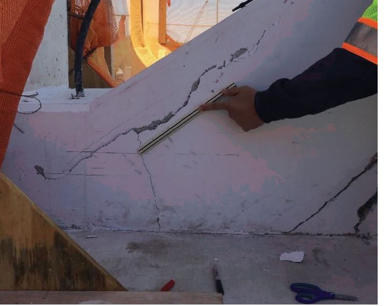

Now that the FHWA/NTSB report is out, criminal negligence charges may develop. You can bet the attorneys have read the reports more carefully than we have.
I can't believe several experienced people observed for real what I saw in a photo and did not pull the plug. I cannot defend that.
I have to hope I would have reacted differently and called for shoring. But that would have been dangerous if began on March 15. It would have taken days to deploy the SMTPs - the outcome was defined before the meeting of March 15 began.
The problem is the node blow out was clearly visible, the cracks had opened half inch, and FIGG were on record prior to collapse as knowing they needed to “capture the node”. So it’s past the point where they can say oops.

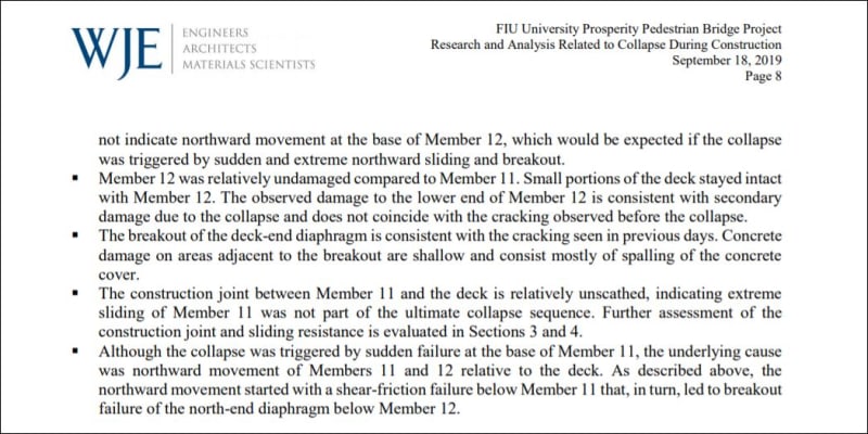

Now to a point made in the WJE report, pages 7 and 8.
This would seem to require further discussion. So WJE says 11 and 12 slipped on the deck then 11 split and failed at its lower end, triggering the collapse.
So how did it "root" out the section below the top of the deck? Did the top of 12 get pulled south as node 10/11 dropped and torque out the deep sections over the 8" sleeve? Was it knocked out in an upward direction as the protrusion of 12 past the end of the deck hung up while going over the edge of the pylon?
Certainly points out the folly in restoring the PT in 11 and increasing the compression load in 11 when it was already failing.

The WJE report that you noted (p. 151, seems to be coming at the collapse from several different angles all at once. But the last bullet point seems most relevant:
"Although the collapse was triggered by sudden failure at the base of Member 11, the underlying cause was northward movement of Members 11 and 12 relative to the deck. As described above, the northward movement started with a shear-friction failure below Member 11 that, in turn, led to breakout failure of the north-end diaphragm below Member 12."

The following is from the WJE report, Page 127.
9 SUMMARY OF FINDINGS AND CONCLUSION
The following summary of findings and conclusion follow from the research and analysis described in
Sections 2 through 8 of this report. The section that relates to each conclusion is indicated.
Failure Pattern (Section 2). A debonding and sliding failure at the construction joint below Member 11
led to breakout failure of the north-end diaphragm and ultimately collapse, triggered by sudden crushing of
Member 11 near its base.

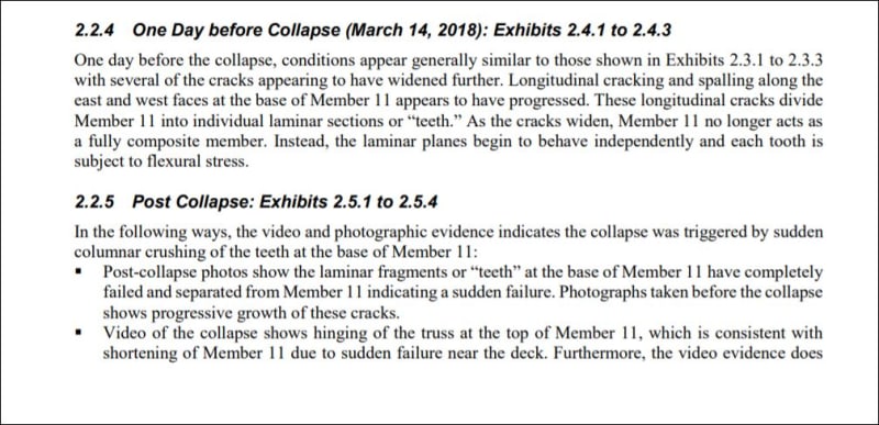

I have previously thought that member 11 gave it up early because of the severe splitting we could see earlier and supported by the recent photos.
We learn from testing by WJE that it takes only about 0.020 inches slip to develop maximum resistance in shear friction. And that at 1/2 inch slip it is over. So at a half inch slip - maybe less - all shear planes had been developed and had failed.
Somewhere between 0.020 inch and 1/2 inch of slip would be a good time for the moments to change in member 11 and the splitting to increase while the joint still has residual capacity to induce axial load in 11, resulting in the loss of capacity in 11, and triggering the failure.
The last two stages were probably a hand off - but it seems that when node 11/12 has failed there would have been a loss of axial force in 11 - except for the upper PT rod.

What everyone failed to comprehend is that the cracking was past the 1/2 inch "I'm gonna fail NOW" mode and as Kenny Rogers said it was time to "Know when to Run!"
One more point about the condition of member 11 - with the failure underway and member 11 already splitting, the idea by the EOR to "capture" node 11/12 would not have repaired member 11. It was all over.

In conclusion, most significant finding from WJE’s research and analysis is that full-scale tests show that if the construction joint below Members 11 and 12 were roughened as required by the FDOT Standard Specifications,
Sorry, but you have been "fooled" by the WJE report.
The "non- 1/4in-roughenning" done in the tests is not the 'roughenning" called for in the FDOT specs when cleaning a joint. The intent of the spec is to leave the joint clean of loose material. Not to chip the joint with a chisel as they did for their so called "roughenning according to FDOT specs". And Florida engineers, designers and contractors know that.
We have to remmember that you have to think like a "Contractor". Chipping the joints requires alot of time and effort that no contractor is going to pay for. So, the engineer (designer) must assume that the joint is smooth (but clean)and apply the corresponding factors in the shear-friction analysis" "non intentionaly roughened" which means no 1/4" magnitude. This is why MCM asked FGG if the joints needed the application of concrete adhesive. And Figg said no: use the FDDOT spec.
FIGG arguments are being laugh at among structural engineers in Florida. But they may convince a jury or those not experienced in Florida bridge construction.
The WJE report is interesting but does not represent the actual situation at the bridge.
What happen is that FIGG forgot to add the note in their erection draawings to roughenn to 1/4" to match the numbers used in the calcs. That is the initial cause of the failure. Still, the structure told everybody it was in trouble and nobody had the "balls" to face FIGG in the meeting, put the foot down and close the roadway: "It was not their responsability"

Zeroing in on this: "Re-Stressing of Member 11 (Section 8). Contrary to FIGG’s instructions, no one closely monitored cracks in the north-end diaphragm during re-stressing of Member 11, even though both MCM and Structural/VSL were aware of the instruction."
This is such an outrageous statement to make! It makes my blood boil just reading it! How many more people would've died if this had action had been followed? What are FIGG and WJE thinking? Sorry for the rant but, IMO, this is beyond the pale.
There was a guy next to the strut #11 taking pics and monitoring the cracks. Lucky him he did not die.
Yes, they were closely monitoring the cracks. But the failure was explosive.
