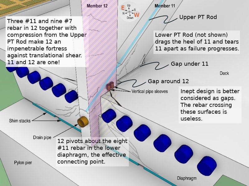

On day one, when the shoring was removed, the deck detached from 12 as per the following sketches (which are exaggerated for illustration). The situation became more obvious with time as the cracks became more pronounced. The structure managed to stay together until 11 buckled/sheared and the span started to go down. As the structure begins to go down, the top of twelve has to move north several inches to accommodate the geometry of the rotating long end of the bridge. 12 is somewhat held in its vertical orientation (though it bows considerably) while the deck rotates the diaphragm off of 12.
These sketches are not perfect but they serve to illustrate the bigger idea of what I'm trying to get across.
EDIT: The east/west arrows on the compass are backwards. It's rather karmic that I took this sketch, and compass, from the NTSB report
EDIT 2: Problem solved!
Further, notice how much of 11 sits on the slab, and that portion of slab did not punch out. It is implausible that 11 could punch out the much heavier pseudo column.
I don't like the term "Punched out".
The 11/12 connection to the deck failed in shear.
The concrete was broken and the joint was held together by some rebar.
The lower PT was anchored at one end to member 11 and at the other end by the deck.
The lower PT rod crossed the existing failure in such a way that increased tension tended to open the existing crack.
When the lower PT rod ripped out of the bottom of member 11 and the rebar crossing the crack failed, the 11/12 connection left the deck.
The concrete had already failed days before.

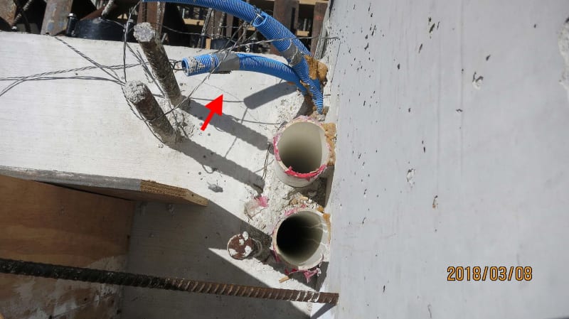

The following photo from NTSB file 628553 , page 11 (Bridge Factors Photographs - FIGG Bridge Engineers, Inc. Photo Submission) - oddly out of dating sequence, demonstrates that failure took place at the back of the diaphragm, in conjunction with the cold joint failure/shearing, while the bridge was still in the casting yard. It is where the energy was relived from the minute sliding of 11 at the cold joint.

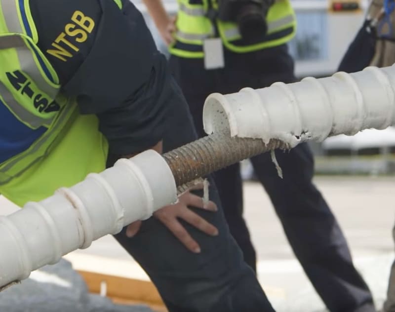

Suppose, for the sake of argument, the 1.75" lower PT rod was encased in a 3" plastic tube. At a 31 deg incidence angle, there would be 2.4" of play. In other words, the relative horizontal movement between the deck and the bottom of Member 11 would have to be at least 2.4" before binding would occur. That is not a likely scenario.
My apologies, I chased that seductive theory myself for a long time and struggled to move away from it even after I first did the calculation months ago.
I'll take up that argument;
A 3" plastic tube will have significant buoyancy in wet concrete.
It will have been tight against the bottom of the PT rod.
The PT rod was anchored to the deck, not to the end of member 11.
It is possible and even probable that the pressure of the plastic tube against the bottom of the PT rod helped the rebar to restrain the 11/12 node when the concrete sheared and the cracks opened up.
I suggest that the failure of the rebars crossing the fracture and the failure of the bottom of member 11 when the PT rod started to rip out happened simultaneously or almost simultaneously.

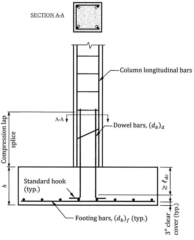

The only thing more laughable than the reinforcement detail at the bottom end of Member 11 is that it wasn't the weakest link in the structure.
Q: What's the purpose of the skewed U-shaped column tie?
A: It deflects the energy to baffle the NTSB!
If NEXT-GEN Column Reinforcement Technology gets incorporated into the building code, all them buildings will slide off the edge of the earth! Call your Representative now!!!

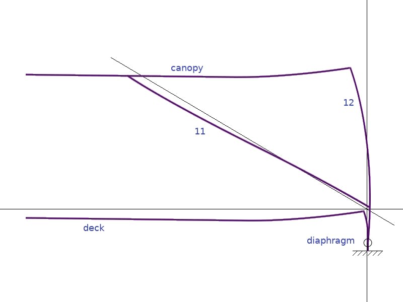

I suggest that the triangle formed by members 11 and 12 and the canopy remained intact during the initial collapse.
The canopy cracked and deflected at the 10-11 node.
This is not consistent with what I see in a frame by frame review of the dashcam footage. Member 11 shrinks either at the 10-11 or 11-12 joint at the earliest movement.

No, that would be the full frame, 720, 10 fps, original dashcam footage with each frame zoomed in so that I can see at least parts of canopy, 12, and eleven with chalk marks and arrow and notes on the back to paraphrase Arlo Guthrie.
I have drawn the triangle of C,11,12 on each frame and compared the frames and 11 shortens. Please go to any one of the many posts on this subject,
