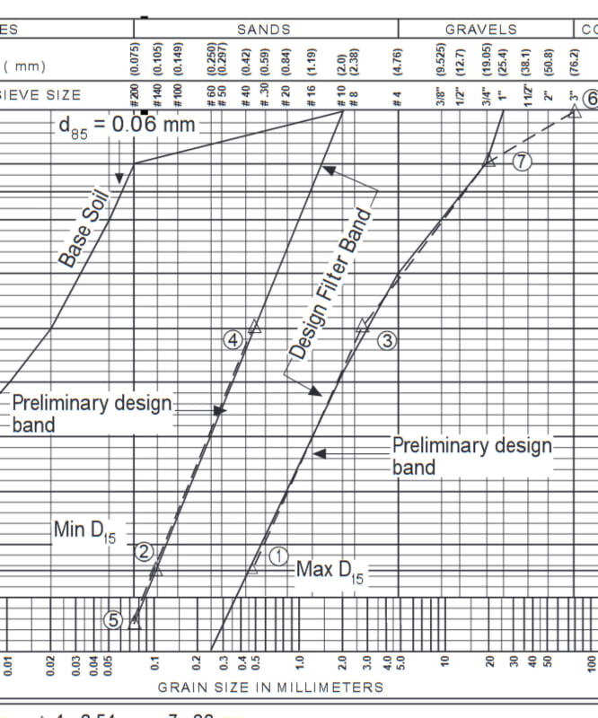

This might best be cleared up as to what is best by using an experienced geotech engineer whom has access to or owns test boring equipment. You wouldn't have to go under, but usually one or two outside test borings outside will be all that is needed. In any case so far I do not see anyone cautioning about what can happen if the drainage system erodes soil or worse yet plugs up. The drain system should be filtered to keep from eroding fine grained soil along with flowing water.. An experienced geotech can advise on that for you for your case. Be wary of a contractor that will install the drains, yet is not an experienced engineer.
So tell us the detail of what you installed as to filter, etc.
The drain is simply a trench dug with a slope to daylight. A rigid pipe with holes placed at the bottom, and gravel filled to the top. No filter.
This is already done so to re-do it for a filter is out of the question.
Just keep an eye on it. It may already have developed a filter having lost a minimum of adjacent fine material. A build up of a delta at the discharge end would tell a story.

moat" around the castle an apply that here. By the way use filtered drains especially near footings. Check out the US Corps of Engineers web sites for drainage and you will seethe gradations that serve best as drain backfill to filter the soil from eroding.
This usually fits the size for concrete fine aggregate and is a great filter.
Note: single size gravel is not shown here as a filter This is all sand for the most part.
