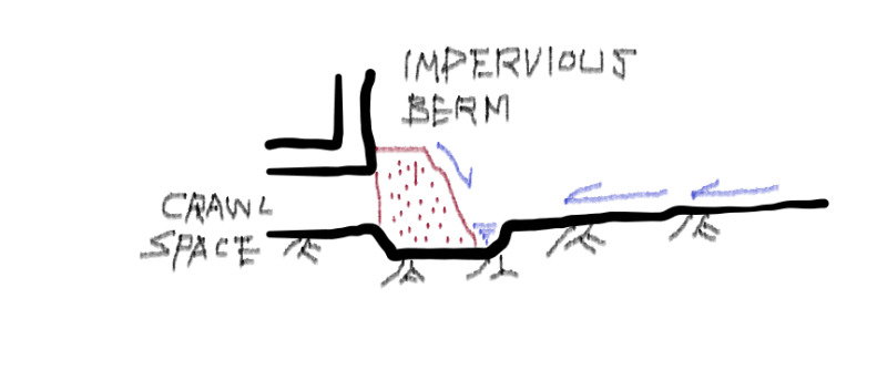

I remember you have mentioned encounter sand layer in a shallow depth. I think it is better to dig a trench behind your house with good slope to divert the water away. The trench should be at least a few inches deeper than the sand layer, so it wouldn't fully inundated by the runoff. If this cuts off the water flow at the crawlspace, then you are good to make further improvement.

Then, don't bother to dig down to any layer, just a trench deep enough not letting the runoff to flow over. Or, build clay berm as suggested.
Just an idea. The berm needs not to cover up the crawl space *which could be much higher than shown), you may adjust the height to fit your need. The ditch can be filled with gravel to protect the toe of the berm.
Thank you for the drawing. What exists currently is essentially what you've drawn, but without the berm.
So most of the water coming toward the ditch(6 inches lower than footer)gets taken away, but with heavy rain there is quite a bite still making it into the crawl.
What I do not know if this is water coming from above, or water coming from the side that is overtaking the ditch drain.

Since your house is on the hill, for an intense rain fall even in a short duration, overflow may occur. Make a small berm (6" say) to test if the overflow stops. Also, another source of water infiltration is from the wind side of crawlspace opening, depending on how height is the crawlspace. Come back and let us know if the problem persists after all these efforts.
If questions still remain (apparently) as to really what is going on, I'd like to see some side view cross sections. And as to water flowing in the ground, it is common if water flows over the surface, it also is moving under the surface,about the same direction, but slower.
