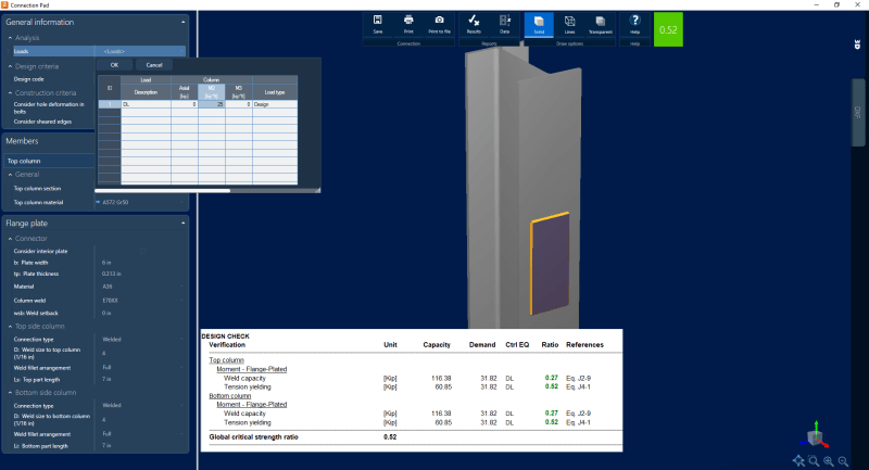

Dear Engineers,
I have got a Beam Splice to design, which has both major and minor Bending Moment (BM). Major BM is 138 kN-m (102 kip-ft), Minor is 30kN-m (22 kip-ft). Please see the snapshot below.
It is taken from RAM Connection Program. The minor BM has been included in the program, but it used only the Major BM.
What I want to know is, the weld shown here for Major BM design, will it be adequate for Minor BM too? or Does it require further checks?
Thanks.

By the way, in Ram Connection the column splice welded flange plate connection can be used to check for minor axis moments so you can turn ths problem on its side to get the relevant weld and plate bending checks.

Vy was not specified in the first post, so I assumed it to be negligible. If Vy is not zero, My is increased by approximately Vy*200. This would increase the weld force parallel to the beam, and in addition, would create a force normal to each weld of approximately Vy/4 in each half of each plate.
