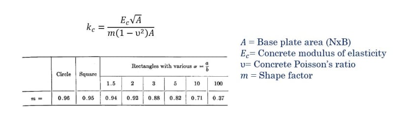

[li]How do i accurately model the stiffness of the grout bed/concrete foundation below?
My thoughts, E of concrete is readily defined, but what do I assume for deflection? What I did in my model was take E*trib area/deflection = stiffness (utilized 8600 kip/in for a 1 square inch finite element)​
[/li]
Utilizing this approach with a linear compression element yields very high concrete stresses. I have stresses in the range of 13ksi. my allowable for 5ksi concrete is around 5.5ksi​
I was thinking maybe I could model some non-linearity into the compression only element to allow for stress resdistrubtion within the bearing area to limit stress to the 5.5ksi range, but I am not sure if that is truly how the grout bed below would behave. I would assume that it locally crushes and fails? My DG#1 original design utilizes a rectangular bearing strength assumption though so I feel ok with this.​

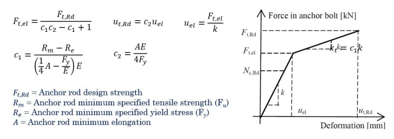

[li]Anchor bolt stiffness?[/li]
I did A*E/L for the anchor bolts. Yields a stiffness of 8020 kip/in. I have a long embedment of 60" on these 3 1/4"Ø ABs​

2) I don't think that I'd even bother trying to model the concrete. In addition to the issues that you've raised, you've also got the flexibility of the soil, the effect of any bolt prestress, creep in the concrete, the flexural flexibility of whatever the heck your foundation element is... on and on. It's a rabbit hole of uncertainty with practically no end to it. Instead, I'd generate a plastic force distribution like you mentioned above and just apply that tot he base plate as a load directly. For criteria, maybe just keep things from yielding or deforming a ridiculous amount.

Not sure I have ever done that. In such cases, I have typically modeled the [perimeter of the] bolt holes as (pinned) support points and added the uplift/downloads (delivered by the column flange/web) where required. Typically the uplift controls the design anyway.....so (for a moment) the inaccuracy on the other side doesn't really matter.

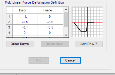

I will play with defining a spring that goes linear elastic up to a point then plastic and see what the results are. Coming up with a rationale stiffness does seem to be quite the rabbit hole, but does greatly affect the bearing results.
You are using FEA results to check the bearing stresses on concrete? Seems a little odd to me. I.e. something that could be resolved much more quickly with hand calcs. (In fact, take away the stiffeners in the plate and it all could be done with hand calcs.)

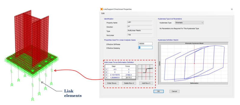

In the frame analysis did you model any flexibility into the base anchorage?

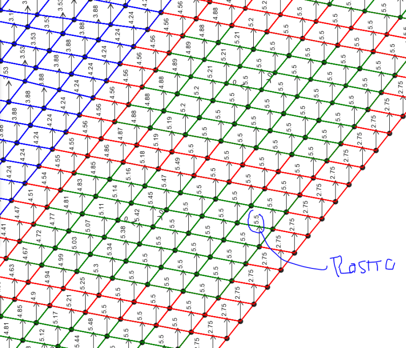

Warose, I would not say that I am using the model for bearing stress calcs, but it is something that I would like to get into the ballpark.
I have "solved" my bearing stress issue by definig a non-linear link element in SAP:
Units of displacement = in, force = kip.
New bearing stress plots look like this with the gap element bahaving as expected (hits 5.5 kips and then goes plastic with a lot more bearing area now).

I have developed a SAP2000 model with compression only elements (gap elements) for the grout bearing, tension only elements (hooks) at the anchor bolt positions and modelled the baseplate as a non-linear shell. This is my first hurrah into heavy non-linear modelling so I am somewhat intimated by trying interrupt my results. I have started with the unstiffened design to get a feel for the more simple approach.
I have also used SAP2000 to evaluate the nonlinear response of base plates as part of a research program. I compared the results with a series of experimentally validated FEA models in ANSYS to calibrate a simplified modeling approach in SAP2000 (less computationally expensive). The results did not match perfectly, but are good enough for design purposes. I think our modeling approaches are quite similar.
These are some of the modeling approaches adopted.
1) The anchor rods where modeled using two-node link elements using a bilinear force-deformation relationship.
2) The column, base plate and stiffeners where modeled using layered shell elements considering the plasticity of those elements.
3) The concrete was considered elastic and was modeled using a Winkler-Pasternak subsoil model. The elastic stiffness of the concrete was determined by theory of elasticity considering the concrete as a semi-infinite solid subject to a uniform distributed load. The solution can be found in Timoshenko & Goodier “Theory of Elasticity”.
4) For load application, a body constraint was assigned to the nodes at the top of the column.

I think it's a very clever solution. What model did you use to find the Force-Deformation relationship of the concrete?.

The SAP model I am developing also works well to take out the conservative nature of the baseplate thickness sizing, you can spot areas of local yielding a make a call on wether you feel OK with that part yielding (kinda of like yield line theory)
A good criterion to establish what level of yielding is acceptable, is setting a limit on the plastic deformation. For example, the Eurocode establishes a maximum of 5% on plastic deformations when designing connections by advanced analysis methods (nonlinear FEA). In fact, this is the same approach behind the software Idea Statica Connection.
