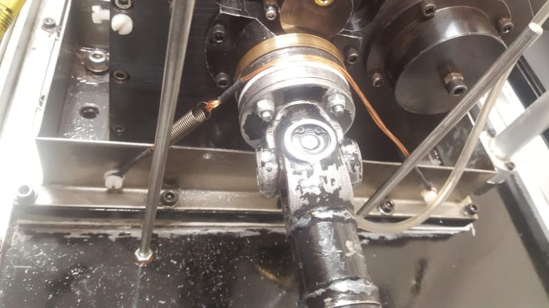

I have two phosphor bronze PB1 sliprings of 60 mm in diameter and 10 mm in thickness and two brushes of carbon graphite with 8 mm in thickness. I am interested in applying a voltage from one of the slipring/brushes contacts, through the shaft (and load) and then collect it from the other slipring/brushes. As I am interested in monitoring this "contact" voltage at high frequency for data acquisition purposes, I have realised that I have an open-circuit at every 1-10 points per slipring cycle.
I have tried multiple different approaches to eliminate this by using different brush spring force, slipring material and conductive grease for the brushes/slipring, with no success. I think one problem that might also influence this is the oil/lubricant vapour reaching the surfaces of the slipring/brushes and act as a dielectric material.
Is there any suggestions/tips of how I can improve the slipring/brushes contact and also keep the lubricant away from the surfaces?

For digital, how about a LED on the axis of the shaft and a fixed photo diode receiver. The rotating circuit can be powered thru a rotary transformer.
Update:
As @Skogsgurra suggested, I have wires to see if that make any difference in terms of improving the electrical circuit and it seems that the wires improve the electrical circuit significantly and I no longer see those open-circuit moments.
I will look into a permanent solution so I can have both brushes and the wire brushes (KC attachment method), so I can assure a good connectivity - will post another update when this is ready.
@Skogsgurra - you mentioned that stranded steel wires are a good choice, however, I am thinking of using KC attachment method on the steel disc while keeping the brushes (bronze blocks) on the slipring. Hence, as I should avoid using similar materials, do you suggest using copper wires for the steel disc (black disc next to the bronze slipring).
 https://files.engineering.com/getfile.aspx?folder=eddc84c2-2c97-48fd-b4db-09907cd87c6e&file=20181115_200726.jpg
Yes. Definitely. Fretting sets in very quickly when you use steel on steel.

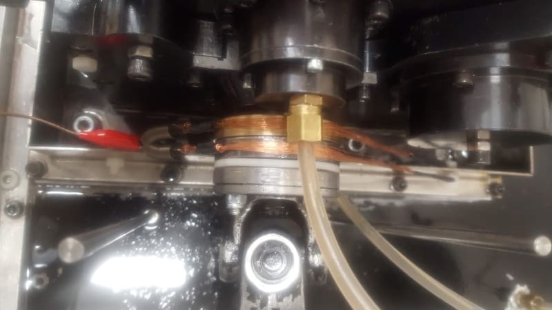

Update:
I have used a setup similar to the one proposed by Gunnar and it worked quite nicely. I have used copper wires to make a rope with two sides wrapped in a circle to make a hook. One side is attached using nylon washer and bolt to the base (isolated) and the other side attached to a spring and the spring attached to the base (with nylon washers, bolt, and nut). I have used the setup for a few days and the wear rate was quite minimal with no momentary open circuits. However, due to high oil temperature, the ropes get dirty quite fast (oil mist and vapours) and need replacement at the end of each test. But overall a good solution.
I am planning to run a long test within the next 2-3 weeks and will update you on this.
Impressive solution. Can visualize bringing the wrap further around the slip rings would create additional surface contact if desired.
Thank you for the posted update.
John
