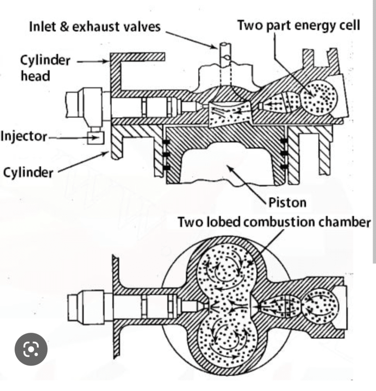

Here is the GM 6.5 example. An interesting detail, the piston is not part of the combustion chamber. This engine has pre-chambers.
Diesel engines aren't subject to the detonation and pre-ignition constraints, so if there's an application for thermal barrier coatings or less thermally conductive materials (e.g. steel pistons), it's there. And they don't rev high, so if the piston is a bit heavier because it's made of steel, no big deal in that application.
Diesel engines with prechambers have gone the way of the dodo. Direct-injection engines are more efficient due to lower heat losses in the chamber. The old GM indirect-injection (prechamber) 6.5 was replaced with the direct-injection Duramax.
The prechambers in the F1 application are really small, a few percent of the total chamber volume, so the thermal losses aren't meaningful in the big picture ... benefit outweighs the cost.
I wouldn't say the pre-chamber has gone the way of the dodo. We were just taking about F1 using a pre-chamber. Also, many industrial diesel engines have spark ignition gas options now which use pre-chamber. The PC is dead for diesel but it's becoming relevant for every other fuel.

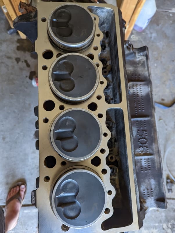

Pre-chamber diesel engines do have a big advantage, they have a wider power range do they run more like a gas engine. I recently blew the 6.2 diesel in my truck which is why I'm building that 6.5. I already committed to making room for a center mount turbo so I could easily fit a Duramax but the direct inject diesel engines don't have the RPM range to make a 3 speed automatic with 4.56 gears drivable. I would have had to make many more changes to accomodate the narrow DI powerband.

Your story rings true. There is a vacuum pump and modulator to simulate a carburetor on my truck as well. I have the TH400 transmission. I had a hard time finding a modulator so I had to drive for quite some time with full throttle shifts only. Part throttle shifts were hard and nearly smack your head on the back window. I trained myself to floor it at the shift points to prevent that.
It's on topic though. My 1.25 ton truck with the 6.2 diesel, no overdrive, and 4.56 gears with 31 inch tires managed 18 mpg. It didn't really manage 65 mph but now with the 37 inch tires that won't be a problem. The fire ring on the head gasket fretted through the block and killed it. The 6.5 I bought to replace it bad the same problem which is why the top deck is so clean in the pick I posted.
The 6.5 has a turbo but also has different pre-chambers. I have no idea what the milage will be. Maybe I'll report back when it's done.
