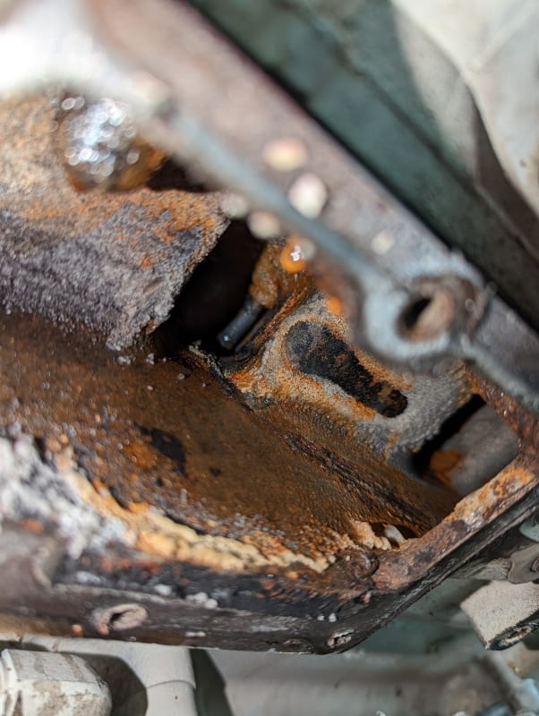

For example, I had to start this engine that has been ingesting salt water. There was still residual water in the intake manifold so I had to use ether to get it going.
The owner warned me about breaking piston rings. They leased me a boat that didn't run. I was damn well going to make that engine start so I could start earning revenue again.
I really despise this series of engines.
