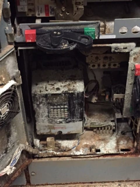

The #1 drive killer... People not taking the environmental issues seriously.
Check out this one;
It's in a garlic plant (not too far from you Keith). The VFDs are in MCCs which were built as NEMA 1, then they "enclosed" them into stainless steel cabinets because they put them in a hose-down area. But the VFDs and starters kept nuisance tripping because everything inside of there got roasting hot, so they took the doors off of the SS enclosures and the MCCs get wet, twice per day. That is MOLD growing on the VFD! Still works though... so far.

Jeff; That is disgusting! Kinda scary too, not knowing where you can touch without possibly getting lit-up. Honestly I thought that was a picture of a burn-out!
A buddies brother was put in charge of a Gilroy Garlic place and they were soo cheap and corner cutting he couldn't take it and bailed out. Maybe the same place...

Probably. They called me in to help them come up with the right steel parts to repair the MCC (see rusty bits in photo). I told them the truth, that their only viable option was to move the MCCs to a dry environment, which for them meant building an annex / electrical room next to the existing plant. They rejected that and opted to leave it as is until something fails.
