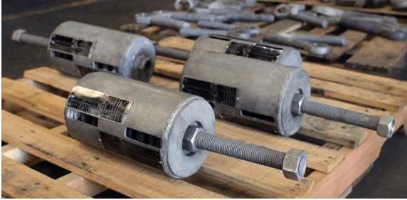

Is your pipe support structure separate from the fan structure? Have you determined if the vibration is coming thru the pipe or the pipe support? Maybe a spring support.
GC, Yes, the pipe support beam is positioned between 2 cooling towers. The beam is fastened to the top of the screen wall framing at each end. The pipe it is supporting runs parallel to the beam and about 45" below the beam. There are 3 hangers roughly 10' apart.
Besides the isolators on the hangers and a flex connection at the cooling tower, I thought about bolting a series of heavy plates to the web if the W18 beam. These plates would function as a mass damper without changing the moment of inertia. The goal would be to reduce the frequency to about 75% of the lowest frequency of the variable speed fans in the cooling tower.
