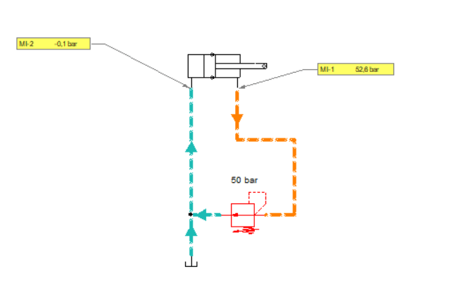

Hello everyone,
the circuit in the picture have port A and B closed (no fluidi can pass through them) and the actuators are pulled by an external force.
The pressure at A will increase until the relief valve opens up (number 55).
Can the cylinder extend?
My opinion is that it can't move if port B is not connected to tank for example.
Yes it can as the fluid now goes round in a circuit once the force is sufficient to overcome the relief valve pressure.
Yes it can - as the pistons move, the additional volume that's created on the bore side of each piston is greater than that collapsed on the annulus side so there's somewhere for the fluid to go. You'll draw a bubble in the bore, so it won't be pretty.

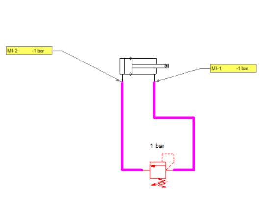

I've tested both configuration, with and without connection to tank using automation studio and cylinder does not move without connection to tank.
Results in the pictures.
Could it be wrong?
You have not specified a limit on the force applied to the rod. If enough load is applied to open the relief valve the rod will move and the cap end will cavitate. I miss where in that simulation you have applied a load to the rod.
Maybe the simulation won't allow you to pull a vacuum? It really isn't a very good idea so the analysis might just stop at that point (-0.1 bar) and say can't be done?
You need to go to prob -1.0 bar before oil starts to pull a vacuum.
Maybe fix the program by allowing air in at 0 bar and see if it likes that instead?
It's not visible in the model but the cylinder is inclined downward of 45° and a mass of 5000kg is connected at rod side.
Put 1 million Newtons tension load on that rod.
Whith 10^6 N cylinder started moving and stopped half way, than started to move forward and backward acting as a spring.
The load limit for my case would be less than 10^5 N.
I doubt it was acting as a spring and more that the simulation failed. Set the relief valve to open at 0 kPA and see what happens.
