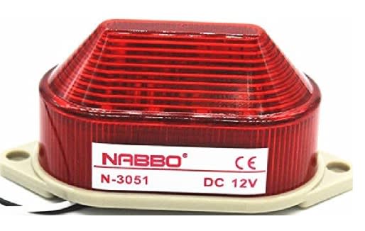

I'm also going to redesign my RED FlashingHV warning indicator, to work on AC and DC
