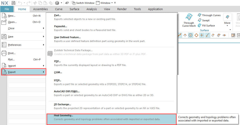

Didier, I don't see your process (box with an "X")?

Hi Bob,
Maybe, you Don't see the image: find attached and the process if File Export Heal Geometry then open the new part.

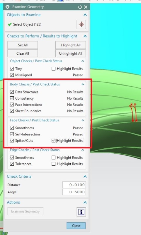

First check your part using
Analysis -> Examine Geometry -> Select with rectangle around solid body
If any of the Checks within the red rectangle give a positive result your body may not be valid, and needs to be fixed.
I intentionally made my body fail one of Checks below.
