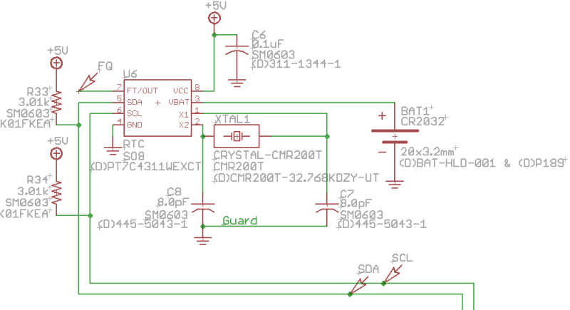

I wouldn't worry about an RTC, I'd just go straight crystal timekeeper. With proper tuning caps on the crystal and at indoor temps, I can easily see less than several seconds/month accuracy. Since that would only be used as a backup during the short time periods you can't get the GPS signal (a day, maybe two at the most?), most users would never notice a difference.
To me, RTCs mean loss of power protection and coin cell batteries for the backup... do you really need to go down that road?
Dan - Owner
URL]
I think Keith already has that designed in. The 8-pin DIL device next to the battery is probably the RTC; I think I can just barely make out XTAL near the pad above the battery.
TTFN (ta ta for now)
Good eye IR!
I've used this RTC for years and years. It's cheap, has a bunch of static ram to keep settings in, that won't burnout like EEPROM and runs for yeeeeears on that particular battery, and won't run on the battery unless power has failed.
(I do find I have to lacquer that bit of circuit to prevent 'funny business' from bothering it.)
