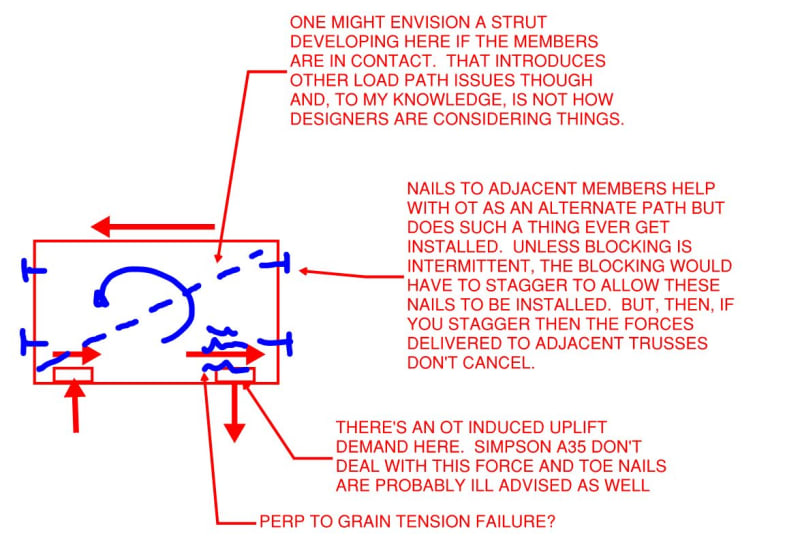

Sometimes, when I attempt to think deeply about blocking, I don't actually love what I find there. At least, that's the case for low aspect, high demand blocking. My sense is that blocking is pretty much the best of the available, practical options rather than a perfect load path. Anybody know of any testing done to specifically target the effectiveness of blocked connections?
@KootK,
They typically toenail the blocking instead of end nail it for the uplift.
When you say "stagger" do you mean offset by 1 1/2"? If so, why would that prevent the forces from cancelling?
Do they actually toe nail the blocking ends by default? If so, I like that. I'll have to start showing that in my details explicitly I guess. Would that require web blocking on a TJI or just nails into the flanges? I know you don't favor TJI's...
Replace "stagger" with "alternate spaces" for the bit on force cancelling.
I suppose web blocking. Yea, I despise TJI's
I typically do show the blocks staggered 1 1/2" if possible so they can be end-nailed. Otherwise they are typically toenailed.
