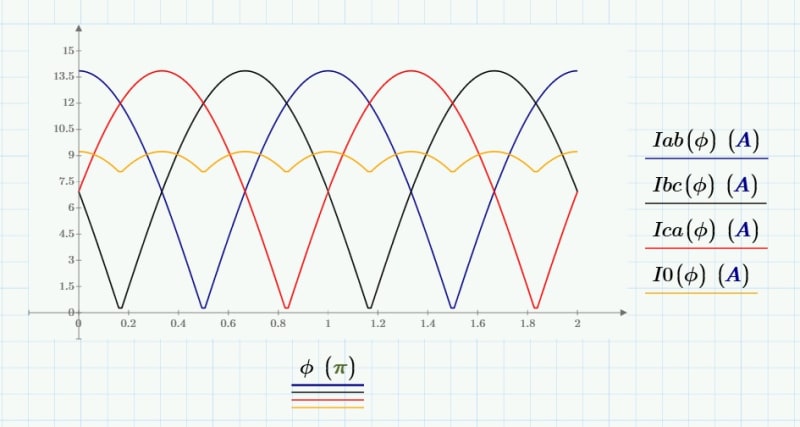

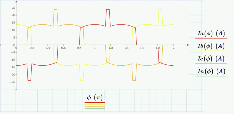

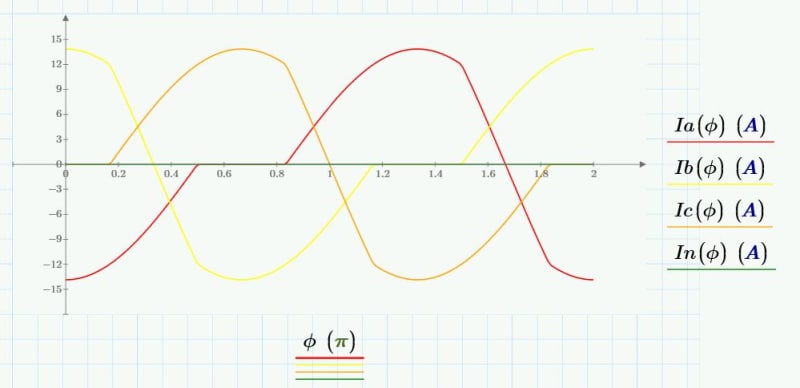

Per Jghrist's Oct 2 statement, I decided to look at a more realistic load using Mathcad. Connecting full wave bridge rectifiers in series to resistive loads, all connected line to line, I get:
and:
Triplens are gone from the lines, but it's still distorted. Not sure how much we've gained with this connection.

I'm not clear about what the currents represent. Is Iab(Ø) the current through the rectifier or the rectified current through the resistance load? It is all positive, so it must be the rectified current. I would think that the current through the rectifier would be an undistorted sine wave. I don't know what I0(Ø) is.
Ia(Ø) would be the difference between Iab(Ø) and Ica(Ø) as they go into the rectifier.

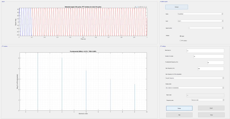

I'm thinking of doing a similar calculation, but with the distorted input to a switch mode power supply. There is an example waveform in IEEE-519.

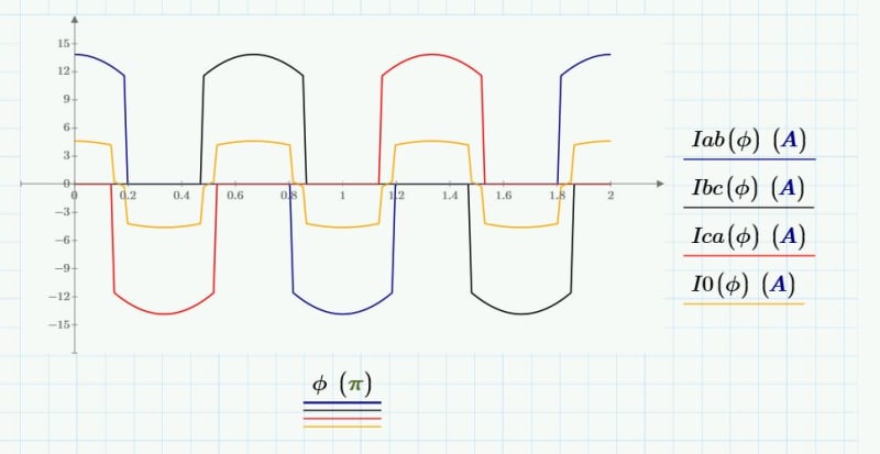

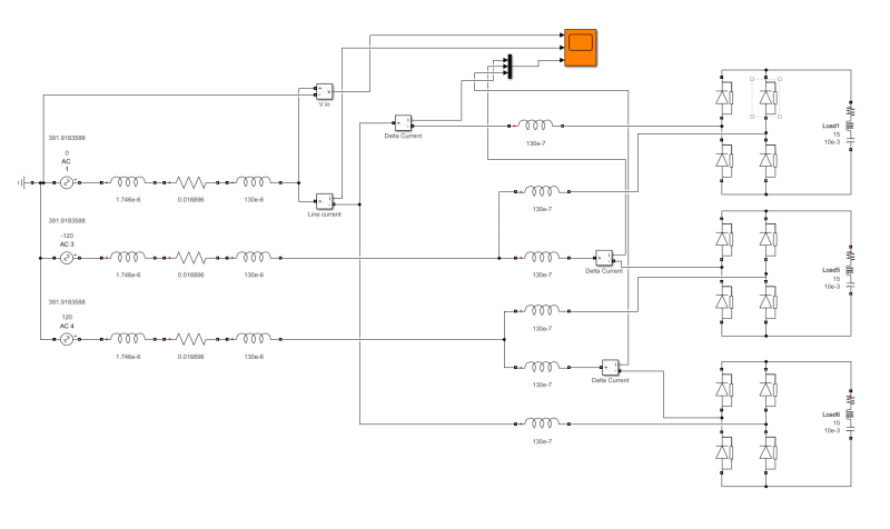

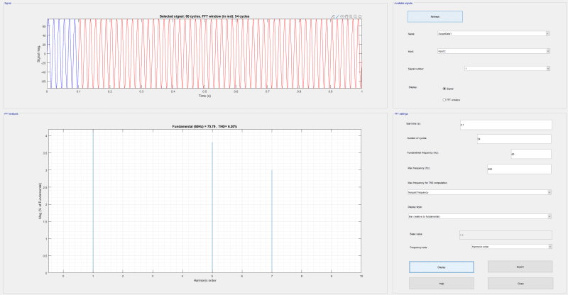

Three separate rectifiers connected line-line:
Voltage at transformer output:
Current from transformer:
Current in the delta formed by the three rectifiers:
Edit: Sorry for the poor image quality; not sure what to do about that. Delta has 3rd harmonic and line does not.

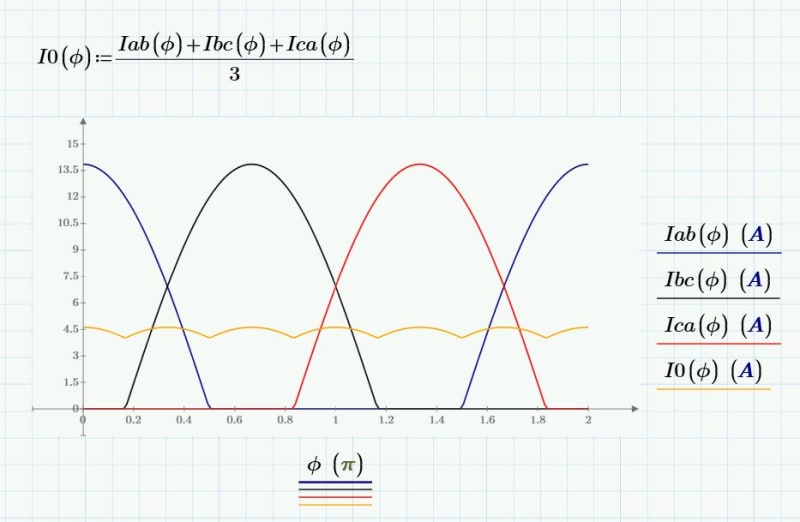

Good questions Jghrist. It would seem my effort to create a more realistic load failed. How about a half wave rectifier in series with a resistive load? Then the rectifier current and rectified current are the same. I0 is the zero sequence current circulating through the loads.
and:

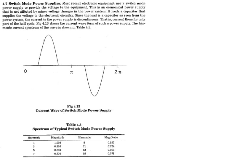

I was considering the following from IEEE-519-1992:
I would use this for Iab, shift 120 deg for Ibc and another 120 deg for Ica. Unfortunately, I am temporarily without Mathcad.
In a switch mode power supply, the current only flows during that part of a cycle when the voltage is above a certain amount.

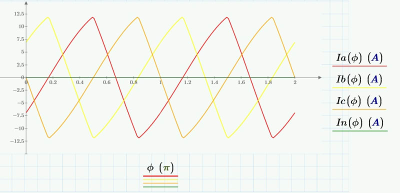

So here's Jghrist's switched mode power supply. Current flows when line to line voltage exceeds 83% of peak. Capacitor neglected.
