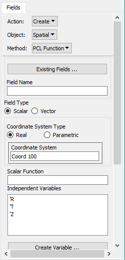

Also, I can't find any resources for how to apply the TEMPP1 information (i.e. the linear gradient) to my model in Patran. Would you be willing to explain it or point me in the direction of good resource?

Well... this is pretty easy to do if you’re modeling your problem as a 2D plane strain or as a 3D model.
To consider the thermal stresses as a function of geometry you must create the nodal temperatures as a function of the geometry (radius in this case)
Let us assume a linear variation of temperature across the wall thickness of the cylinder of the form:
T = To + (Ro-r)/(Ro-Ri) *(Ti-To)
where:
T = Temperature at a given radial distance 'r'
Ti = Temperature at the inner wall
To = Temperature at the outer wall
Ro = Outer radius
Ri = Inner radius
r = given radial distance.
You can use the Create--> Spatial---> PCL Function option in the 'Fields' menu of Patran to enter this equation. The FE-model needs to have all the nodes associated to a radial co-ordinate system for Patran to pick up the radial distance of a given node in your model.
So, give a name for your field under "Field Name"
Use the Field Type as "Scalar"
Co-ordinate system type as "Real"
Under co-ordinate system select the radial co-ordinate system that you have created. (The coord 100 that you see is the radial co-ordinate system that I had created.)
Now considering the temp and geometric values in your example the equation in Patran would be entered as:
70 + (0.233-'R)/ (0.233-0.172) *(1000-70)
under "Scalar Function". 'R is the Patran convention for the nodal radial distance.
Now in the Loads menu under Create--> Temperature ---> Nodal under "Input data" select the above created field in the 'temperature' box. Click on the "Select Application Region" and select all the nodes in the model. Hit Apply for patran to interpolate the nodal temperatures. Once you run the model you'll have the variation of thermal stresses across the thickness.
Now the model that I did was a plane-stress model using 4-noded shell elements. The temperature interpolation across the shell thickness was done using Create--> Temperature ---> Element Variable. In the input data you just enter the top and the bottom surface temperatures which would be To and Ti respectively. In the Select Application Region, just select all the shell elements. This automatically creates the TEMPP1 card which contains the parameters for Nastran to do a linear interpolation across the shell thickness. Refer the nastran quick reference guide for more details on the parameters of the TEMPP1 card.

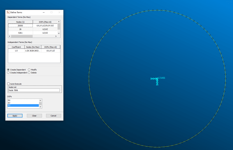

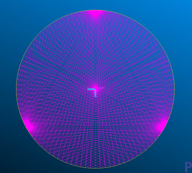

I would recommend to use datum cylindrical coordinate system and apply theta and axial constraint at the ends directly as stated in my first post rather than doing whole RBE3 exercise.
Interesting slideshow on RBEs. I am not sure I fully understand what it is saying though.
It looks like it is saying make 3 nodes the independent terms in an RBE for all 6 DOF, then, for every other node, make it the dependent term for those three independent terms in all 6 DOF.
That must not be the case, because I just tried it and received an error.
Could I not just constrain the entire side in rotation and axial directions to achieve a similar result? Or does that add stiffness to the model.

If you look at slide 44 that's all you need! Just one wagon-wheel RBE3 at one end of the cylinder which connects the dependent node at the center to the independent nodes on the circumference. Use dof's 123456 for the dependent node and 123 for the independent node. Select 3-nodes 120degs apart on the circumference and add them in the UM nodes putting theta and Z dof's in the UM set. Add a SPC 123456 at the dependent node at the center. This method constrains all rigid-body modes and allows for un-constrained motion when you have self-equilibrating mechanical loads and thermal loads (such as an aircraft in flight) without constraining the model to ground. This is a generic way of doing it.

So, the best I can understand this is to set up the center (20000) as a dependent node in 123456. Then add every point on the circumference to the independent set in 123. Then, to achieve a similar looking RBE3, add the three separate points that are 120deg apart to the dependent set in 36 (translation in Z and rotation in Z with Z being along the axial direction).
The center node has a SPC 123456 and it is the only SPC specified.
Does this sound right to you? Because I still seem to be getting errors once I submit the job to Nastran and check the F06 file.

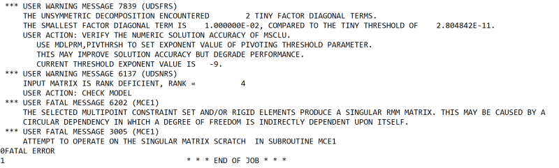

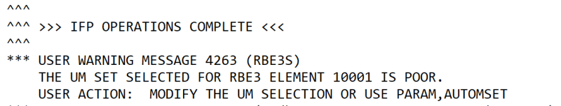

How odd. I reconfigured the RBE3 to have the 23 DOF for the three nodes, but there is still an error.
In the F06 file, the OLOAD RESULTANT matrices for each subcase has approximate zeroes everywhere.
However, there are two sections with error messages. One concerning the UM set. The other concerning the matrices. (Attached photos for F06 text)
It seems like a DoF in the RBE3 is dependent on itself in some way. Thinking this could be a problem with the three 23 DOF nodes being in the dependent and independent sections?
Seems weird that I would receive this error if you are not and are performing this same operation.
Attatch your input file which FATAL's out. I'll have a look to see what's going on.
Ah. Well, after playing around with the coordinate system, I found that there were issues with the nodes RCID versus the ACID.
