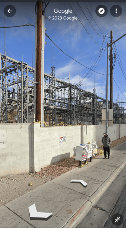

I was in Vegas the other week and this is what their substation looks like.
The problem isn't really people targeting substations in general, it's their rural location. People are more likely to misbehave if they think nobody is around.
You really want to hide something that ugly...

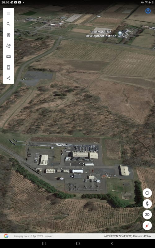

I had to locate a 10,000 kW compressor station in Princeton NJ in an area with $25M estates. We bought a big plot, used electric drives, limited noise to 70dB at the property line, built well back from the main road, built in a bit of a river valley, cut the hill to screen the pipe runs, put compressors inside a building, used the shop, warehouse and office as visual and noise screening and planted a tree line on the other side. You can only see it from the air. Got Princeton's planning approval on the first pass. Never happened previously. It can be done.
