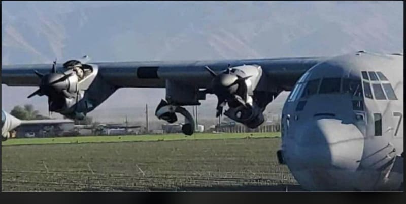

The pilot and co-pilot deserve a medal for that landing. I have to believe that the 'pucker factor' was really high as they approached that farm field.
The question now is, how in the heck are they going to get that plane out of that field?

The herc pilots did a great job with the forced landing, but I must admit my interest is mainly in why they couldn't fly to a runway with 2 engines still working.
It looks like they didn't have any flaps out which would indicate they had lost all hydraulics which would have effects on the amount of muscle force required to move the controls and a very much increased speed on touch down.

To get it out the field they will take the wings off and stick it on a low loader lorry and drive it out. It will be no bother to the US army Engineering corps, who will then remove all the contaminated soil from the fuel which will more than likely take more time and effort than getting the aircraft to a repair facility. The J is easier to strip down the the C and they have shipped them in C5's. The C had old age issues with wing spars running out of life and they replaced them, so the J they seem to have designed so that instead of having to take the whole lot to pieces to change the spar they can just detach the wings and replace them.
