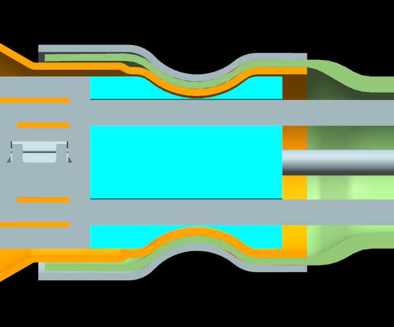

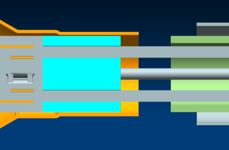

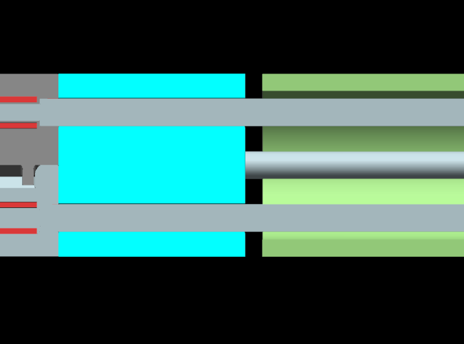

I am in the process of pulling all of my formed bodies out of my parts and making them separate parts. But I will try and post some pics to explain:
The first pic shows parts before entering 2nd asm.
The 2nd pic shows sleeve (green) pulled back, and uncrimped parts ready to be crimped.
The 3rd pic shows the end result, with 4 parts formed, sleeve is sandwiched in the crimp.
I had all different shapes as bodies in the parts, intending to use reference sets to show different in each assembly. I could not get it to work reliably.
