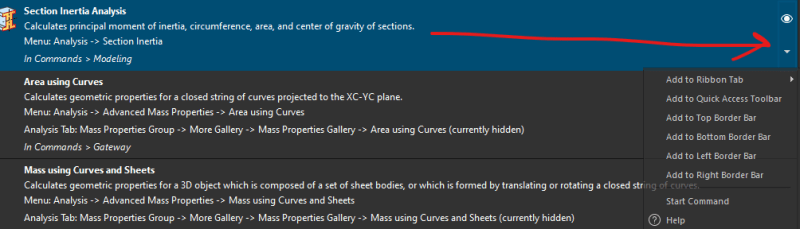

Actually, your "old way" still works, just not by right click, but by clicking the down arrow button thing on the right edge of the found command:
