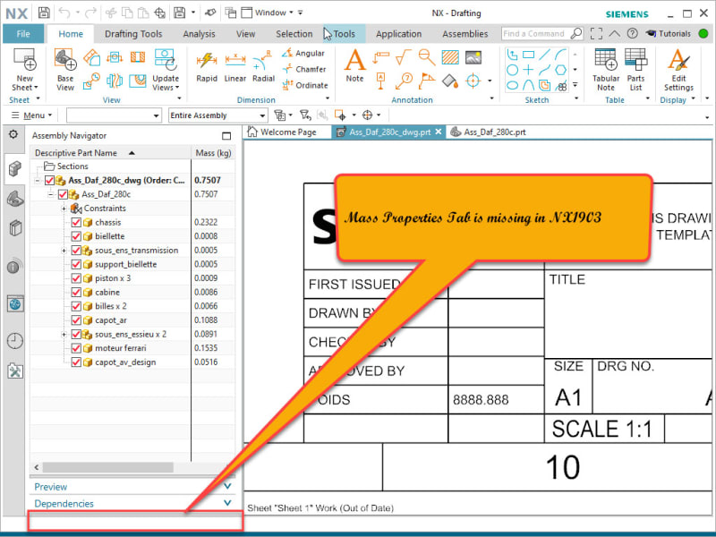

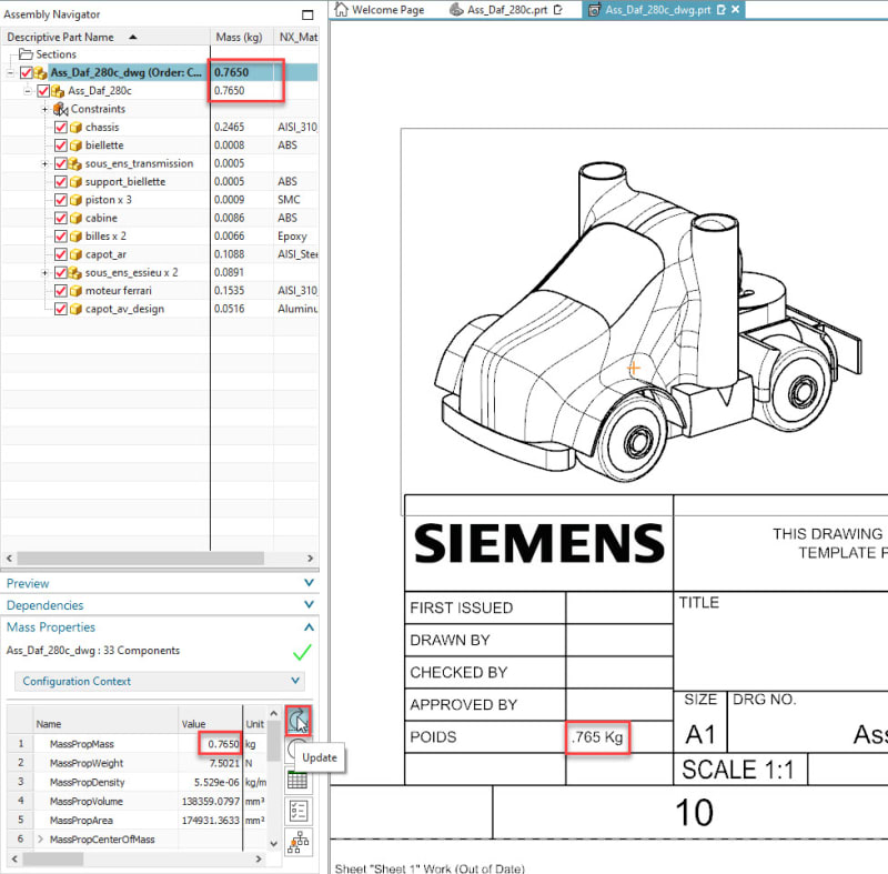

Hi Anthony,
As I have said, I have large assembly module with my Mach3 Industrial Design.
With the link to the forum, I have found the answer to display the mass properties panel
So, It works, but how to have an automatic update ?

I have found that It should update upon saving if Generate Mass Data Upon Save is ticked on our Save Options.
But it should also update during drawing update.
It's a reason of error, because we can export pdf with a wrong value
I will open an ER
Regards
