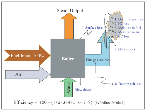

What is the fuel input to the boiler to make 1,000 lbs of steam? You can figure that off boiler efficiency (you've posted the annual numbers). What is your cost of a million BTU of fuel? Once you have that, then you can calculate the savings on each 1,000 lbs of steam not required by your process.

The boiler efficiency cannot count the heat value of the feedwater, so that must be subtracted from the heat output. What is the BTU/lb of steam leaving the boiler? What's the temperature of the feedwater entering the boiler? Get the heat values for each off the steam tables to see what the boiler is adding to each lb of water to generate a lb of steam. Apply that value to the annual steam produced numbers you provided. Then divide the BTUs out by the BTUs in - again from the number you provided. Multiply by 100, and you have the the boiler efficiency.

ASME-PTC4.1 Steam-Generating Units is the standard method of determining boiler efficiency. It treats the boiler as a control volume with inputs and outputs. If you want to use this method get a copy of the standard, or search out one of the interpretations available on line.
