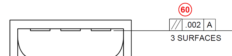

Morning all,
I wanted to get clarification from the experts on this, being that I don't have direct access to the Y14.5-1994 standard. We have a parallelism callout to 3 surfaces back to -A-, and there is debate in my department about whether this is meaning to treat the 3 surfaces as a single plane for this purpose, or if its a callout for each pad individually. My understanding would be that without the CF modifier, this callout would be for each pad on its own. Thanks in advance for your time.
The CF modifier was added only in the 2009 revision of ASME Y14.5.
I conclude from your post that the relevant standard is the 94' version.
Either way, the specification as shown does not require coplanarity. For coplanarity control, profile tolerance specified for the 3 surfaces would be the correct requirement.
As shown, the tolerance can only apply for each surface separately when interpreting per the standard, but that is not necessarily the intent of the drawing maker. Unfortunately, there is a significant chance that the original intent was to impose a common tolerance zone. It is a common drawing mistake.
Inspector_Brent,
The continuous feature symbol was an addition for Y14.5-2009, it was not present in 1994. It has been further expanded in 2018.
While the intent may have been to create 3 coplanar tolerance zones I don't think that would be the default interpretation, even with the "3 surfaces" note. You would have to either add a clarifying note (while not strictly supported, a CONTINUOUS FEATURE note may get the point across) stating that they are to be coplanar or employ profile to enforce default coplanarity.

While the intent may have been to create a single plane from the three surfaces, this doesn't do it. Parallelism does not locate features; not to a datum and not between features. All this does is ensure each individual surface is parallel to the datum, there is no coplanar control.
