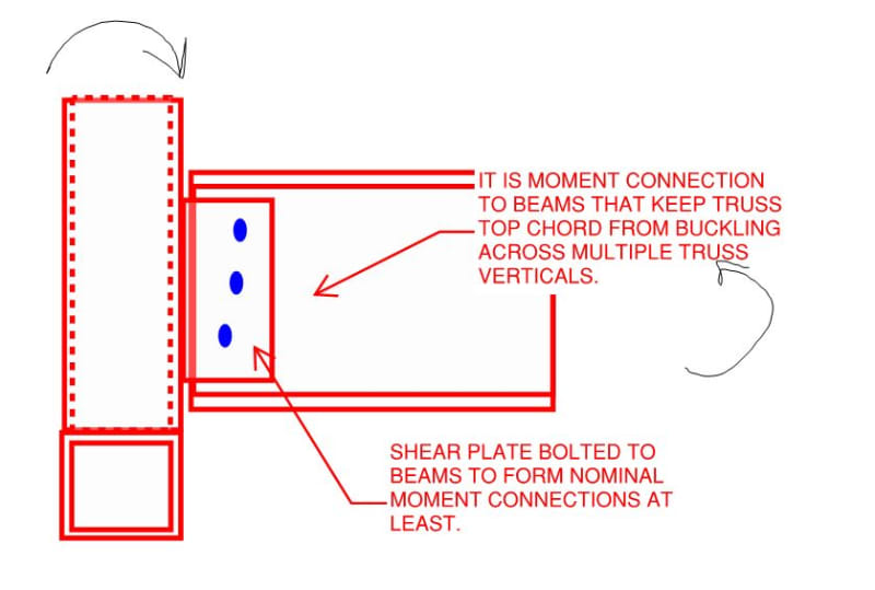

1) I'm not a bridge guy and I'm not great with AASHTO so take my advice with a grain of salt. If you provide the relevant AASHTO provisions and issue year, I'll check 'em out though.
2) Recognize that is the moment connections between your truss vertical and your beams that are stabilizing your truss top chords against buckling. It sounds to me as though you've got that part.

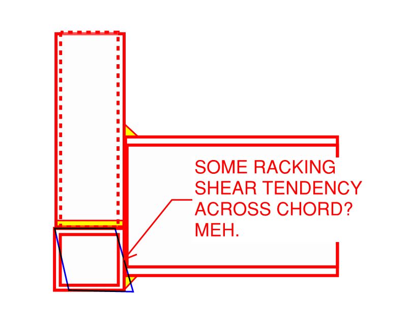

3) Because of #2, I suspect that the point of the AASHTO provision that you mentioned is to prevent excess flexibility in the moment connection mentioned in #2. Too much flex in too many HSS walls for anybody's liking.

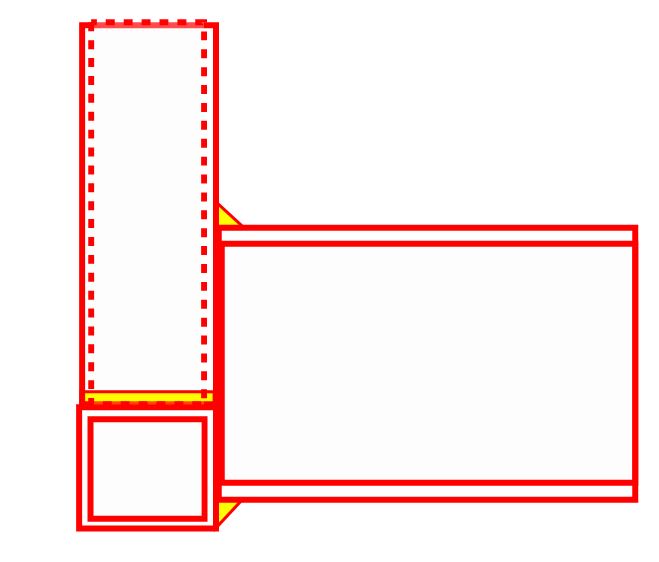

4) I think that raising the beams a bit above the bottom chord as shown below might be a practical solution. It's not a super robust moment connection but, at the scale of this structure, I feel that it would be adequate if you can find some way to evaluate the joint flexibility rationally.
5) I do think that an all welded connection would be enough if you make it directly to the verticals rather than the bottom chord.
Frankly, again at the scale of what you're contemplating, I feel that this would be adequate as well.

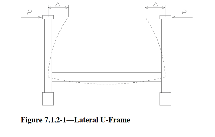

Gus, I think that the code is discouraging that type of connection if you are looking to rely on U-frame stiffness, which may be useful for you.
It would need to be a welded joint, not just a shear tab if you need a moment connection, and thus, U-frame action.
 https://files.engineering.com/getfile.aspx?folder=878aad13-ba5f-4963-84c0-81736bdf995f&file=SKM_C55820070608060.pdf
This is the cross section in the AASHTO guide.

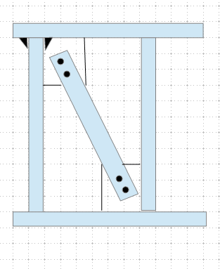

Why not? Below is a suggested detail. The gusset is attached to the slotted HSS using thru bolts, I think AISC has similar detail/examples.

As you've sketched your truss, there's no way to get around one or more of your vertical post / floor beam frames having to stabilize the top chord. As such, I'd recommend embracing that stability mechanism in some fashion rather than trying to circumvent it.
