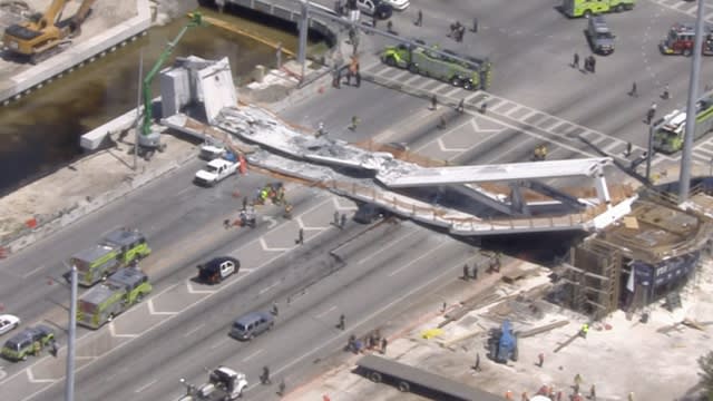

The code statement you referenced about framing into the bottom chord was placed there by yours truly (via appropriate correspondence with the AASHTO committees). The problem with framing the floorbeam into the bottom chord is that the chord will "ovalize", as shown in KOOTK's post and referred to as "racking". The floorbeam should frame into the truss vertical for maximum stiffness. You can also frame the floor beam below the bottom chord ( we commonly call this an underhung floorbeam) but you loose about 10% of stiffness in the connection. (Stiffness being the spring constant "C" value calculated with an average/typical size pedestrian bridge).

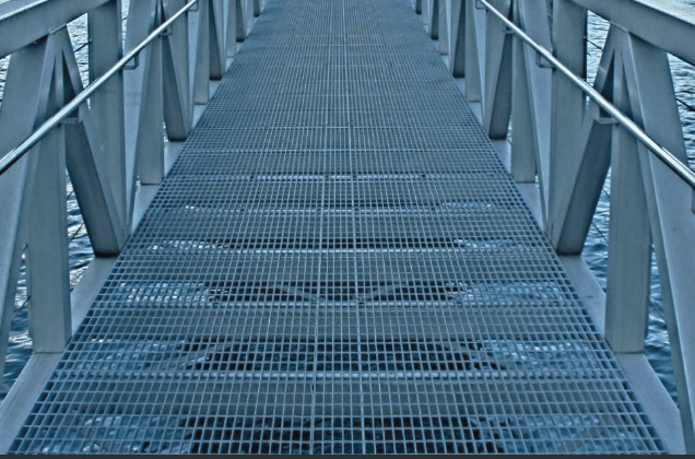

A bar grating would be another alternative (see below). For a width of 6m, you really should come up with a better framing plan than 5W16 @ 16" centres. The beams should be deeper and spaced further apart for economy. A spacing of 400mm (16") is not reasonable.
The client needs to give you the freedom to design the structure in a way that makes sense.
