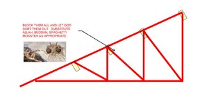

I have a series of wood trusses terminating on the interior of the building which have some very tall heels (13'+)
There is no shear transfer by design here - although some might occur in reality.
I'm leaning towards sheathing this section full height, but am wondering if that might be overkill - in lieu of X-bracing.
(truss profile is hatched in figure below)
OP started this thread by proposing sheathing the truss verticals over the interior bearing, specifically not for VLFRS. And several of our friends here have expressed support for that. Is sheathing that surface not functionally identical to installing full height blocking? I feel that it is.
I agree with you here, and was trying to make that exact point. The sheathing in OP is similar to blocking at interior bearing, yet I would imagine that few of those who expressed support for the sheathing would also be in favor of blocking at interior supports (but could be wrong).
Personally, I do not feel like the sheathing is needed, nor blocking at interior bearings (provided adequate chord/web bracing are provided) unless part of LFRS.
Are there any other meaningful examples of deep wood framed members that either do require some sort of "rollover" or torsional bracing @ bearing, or do not that come to mind?
The most common one that I know of is so close to OP's case as to, probably, be uninteresting. Light frame unit/corridor setups. Here, full depth blocking is usually considered impractical. So you're relying on lateral restraint of the bottom chord coming from the corridor wall top plates. Those, in turn, are themselves laterally restrained by the corridor walls -- intentionally or incidentally -- behaving as shear walls.
Another example is floor trusses at interior supports (multi-span, not continuous). There you will typically just have the ribbon which, in my opinion, is only there for vertical load distribution, not rollover resistance (no doubt it provides some).
I've looked at a number of wood beam over girder industrial building where the beams were set up Gerber style with no rollover bracing. This is kind of ambiguous though because the beams are usually so stocky that they probably benefit from pretty decent "bracing" just by virtue of their own geometry.
