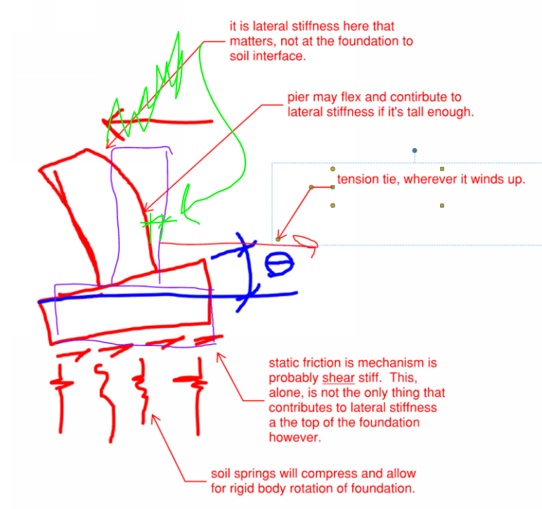

Hi all! I am working on a PEMB with a 200' clear span, with factored horizontal reactions of 240kip at the baseplate. I am really struggling to get this magnitude of a shear reaction into the the pier and then transferred into the tie-beam. To make things extra fun, I have two frames where my tie-beams will intersect pits in the floor, and so the tie-beams want to drop down 24" below the top of the slab, which makes the pier ACI anchor rod checks impossible without an 8-ft square pier (I also tried the strut-and-tie approach with no luck).
All that aside, my "typical" tie-beam that I am somewhat comfortable with is 24"x16" concrete beam with (12) #10 bars. For various reasons (like welded/mechanical splices, and a slightly questionable approach to lapping the beam bars into the shear cone of the pier) I am thinking of using a concrete encased HP10x42 beam instead of rebar for a tie-beam.
Am I crazy; anyone ever done such a thing? Pro's: I could splice the beam to a setting plate with a heavy bar and hang my hat on the shear transfer; two beam splices in the span is pretty straight-forward; there's not a bunch of rebar to deal with, etc. Only Con that comes to mind is burying a steel beam even though it will be embedded in concrete....not sure why that gives me pause?
Appreciate any thoughts anyone may have!

KootK said:
Correction to my sketch: it's the lateral foundation movement at the elevation of the tie that matters for the tie (obviously).
The big elevation difference between the base plate and the tie might make for some pier rotation as I mentioned earlier. I stand by that. However, if the tie and the footing are close in elevation, as I believe them to be, then that rotation will have a pretty minor impact on lateral movement at the level of the tie.
As with most things dirt, I'm willing to do most anything that a geotechnical engineer will sign off on.
So counting on passive resistance is out; I should thought a little harder on than before I even posted it.
At Section 5 of the attached, there is a weldment connecting the PEMB base plate to the tie-beam reinforcing which is mid-height of the pier. Max thrust is 167k (D+S), max sliding resistance at the bottom of the footing is 49k. Due to the offset between the thrust load and the ties, there will be overturning to the foundation and/or bending to the tie-beam. I have a hard time with resolving whether or not to count on the sliding resistance to reduce the thrust load that the tie-beam should be designed for in this detail; it seems that the direct connection doesn't care about the sliding resistance. It would seem that as the thrust load increases, elongation occurs in the tie-beam allowing lateral deflection of the pier and rigid body rotation per KootK's sketch while the sliding resistance keeps the footing in place until the load exceeds it. So maybe it starts snowing, and when the thrust reaches 49k there is ~.25" elongation (with the current rebar design) in the tie which allows the pier to deflect and the footing to rotate and as the thrust increases beyond that the footing slides with the additional tie elongation?
Section 8 seems much more straight forward to say by inspection that the thrust can be resisted by the combination of the sliding resistance and the tie-beam.
But I 100% agree with KootK's point that the critical thing is where the top of the pier winds up in all this....seems like an awful lot of discussion for a serviceability issue but I like it!
From a design perspective this is a pretty easy one to KISS-it and ignore the sliding friction for the tie-beam design for sure....really wish I was involved before the contractor bid and won the project!

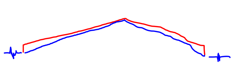

KootK - I see that snap through buckling, but I wonder if there's enough stiffness at the knee to resist outward thrust enough to produce it. Can't really check because the knee is the PEMB guy. Plus the column deflects and isn't a good "fixed joint" for the snap-through. The roof diaphragm may offer some bracing along the length, or the erection bracing/cables, but... I suppose it's an engineering judgement question.

I abandoned snap through once I saw how small JAE's elongation numbers were.
I see base plate lateral deflection as adding to snap through potential, not reducing it.
The general premise that I was working under was that, if you make the thing long enough without proportionally increasing the sidewall height, and it approaches the system shown in blue below.
