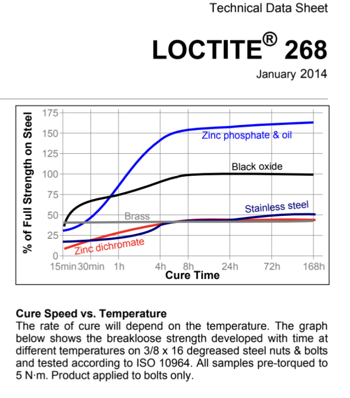

I have two parts that need to be permanently threaded together.
One is cast aluminum with a 1/2-14 NPSM female thread.
The other is galvanized steel 1/2-14 NPSM nipple.
We currently use Loctite (the glue stick ones, primer green + high strength red) to keep these parts from rotating relative to each other.
Is there another way that we can thread these together so they never come apart/rotate relative to each other?

We're using 268. It's been generally fine, but I had one fail. Maybe I didn't use enough.
Would love a mechanical solution, but obviously hard for ya'll to suggest without seeing the product.
@JohnRBaker
Any specific type you'd recommend? Easy application would be critical factor. Also must seal the threads (which the loctite does) and cure relatively quickly (<12 hrs to 75%).

Acrylic adhesives tend to have stronger bonds than epoxies. Loctite 268 is an acrylic adhesive.
The bond strength varies a lot based on material. The cured strength on zinc chromate is very low. Consider acid etching the threads of the steel component to remove the zinc chromate coating.
I would bet the joint that failed did so from using insufficient material (unlikely as most people use far too much) or the threads were contaminated with oil or grease. It could be someone used a shop rag to wipe down a thread to "clean" it.
You can try epoxy, but if locking compound isn't working I don't see that epoxy will be better. The options to screw up epoxy are larger.
The main difference is epoxy will generally cure all on its own while anaerobic adhesives need to be removed from oxygen and so won't cure outside a joint and won't cure without primer on non-reactive metals.
I think there are primers that brush on and then are let to dry and those should give a better result than a solid stick. Use in conjunction with Locktite 271. Be aware that 271 removal instructions include a blowtorch while installation instructions include clean and dry surfaces and shaking the bottle.
Thanks @TugboatEng - The part will see rain, so not keen on stripping the coating... maybe a material change is in order but I don't know what to switch to. FWIW we are using the primer.
@3DDave - thanks for the tips. We are using the primer. I think I just didn't use enough (has this "less is more" refrain from the vendor playing in my head...). We tried liquid with spray primer initially - the sticks worked better for some reason.

Consider substituting electroless nickel for zinc plating. Thread lockers work better with nickel than zinc. It will also provide better corrosion resistance.
Is your aluminum anodized? Thread lockers don't cure well with anodized aluminum.

It sounds like these materials are not ideal candidates for threadlocker. And yes, the aluminum part is anodized (thanks @TugboatEng - can't believe I didn't think to mention).
We really have tried a range of threadlockers, and this combo worked better than anything.
@dvd can't tell if you're serious lol - I think the tolerances would be too demanding.
Anodizing mostly stops the cure where zinc chromate results in a poor bond . There are accelerators you can use to improve cure time with anodized parts.
