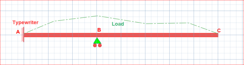

Let me clarify, the scenario I'm talking about is a single beam fixed at A and propped at B with a roller.
The structure below has one degree of indeterminacy.
Using the slope-deflection equation, clockwise positive,
Ma = FEMab + UMb/2
where FEMab = Fixed End Moment[A-B] and UMb = Unbalanced Moment @ B (i.e. FEMbc - FEMba)
BA
BARetired,
Thank you. I use the force compatibility method and solve these with displacements. My original question was about whether or not you know of any beam formulas, similar to those found design manuals, that quickly solved these types of beam reactions for various loading patterns. I’ve noticed that most manuals don’t cover this particular cantilever with one propped end and overhang.
Sorry, but I don't know of any formulas or manuals covering this particular case.
Remove Support B, calculate deflection at B from applied load, then determine reaction at B to produce the same deflection.
