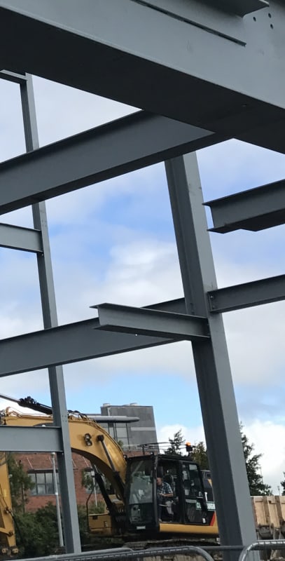

Check this one out - the temporary stability of a 4 bolt “pin” before the masonry wall under was built.. So it has some degree of fixity but we still call it pinned.
That's a good point. The beam designed as pinned is more stiff than if it were designed as fixed, and the stiffer it is the less it rotates at the ends and potentially overloading the bolts.

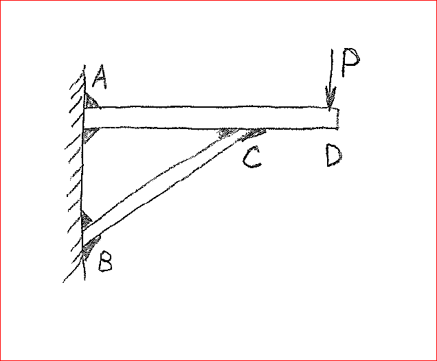

You're welcome dik. A similar situation arose in thread507-491227, quite recently. The OP's sketch is repeated below. I was among those who recommended using the determinate case of having all joints pinned. It turned out that, when all joints were rigid, the horizontal reaction at B, and hence, the axial force in diagonal BC was greater than the case where all joints were pinned. The thread terminated without that point being discussed.
In the propped cantilever example which I mentioned earlier in this thread, fixing the joint at Point A effectively shortens the back span from 3m to 2m, which increases the column load from 2.33P to 3.0P, a ratio of 1.286. The ratio would be still larger if the cantilever length were increased.

Be wary of counting on fixity during erection like shown by MIstruct - almost certainly going to work for an end plate connection like in the picture, but if done with clip angles the beam will just fall to the ground (IME when a contractor didn't properly rig a beam and a drift pin fell out).
