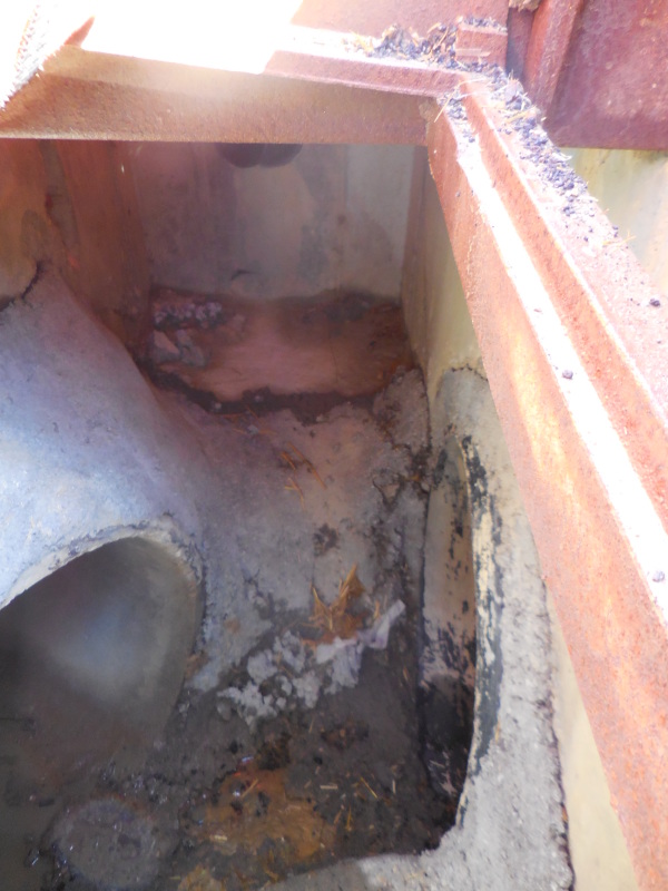

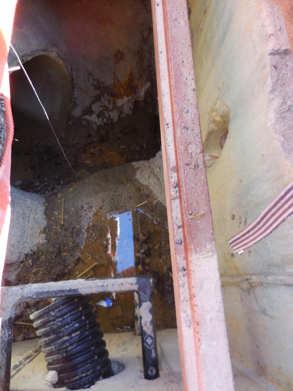

All, here a couple of pictures I took today. I should have gone yesterday right after it rained. There isn't enough water to determine anything.
Photo looking into the curb inlet. 24" pipe inlet on left, 6" curb underdrain near step.
Photo at same location, lower. Notice grouting around 24" inlet (RCP) and outlet (HDPE) pipes. This confirms the pipe is only soiltight (ADS detail 202A).

I will post more pictures once we have a larger rain event.
