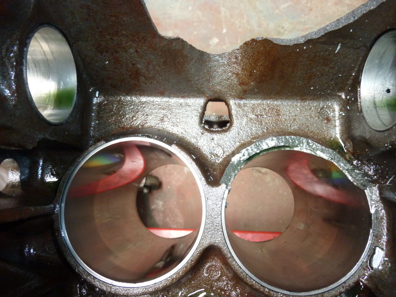

I reconditioned a friend's engine which broke later on during running in.The piston broke just on the pin line,conrod bolts snapped clean off, smashed the whole block.
My question is: is this always due to overreving or is there another possibility?

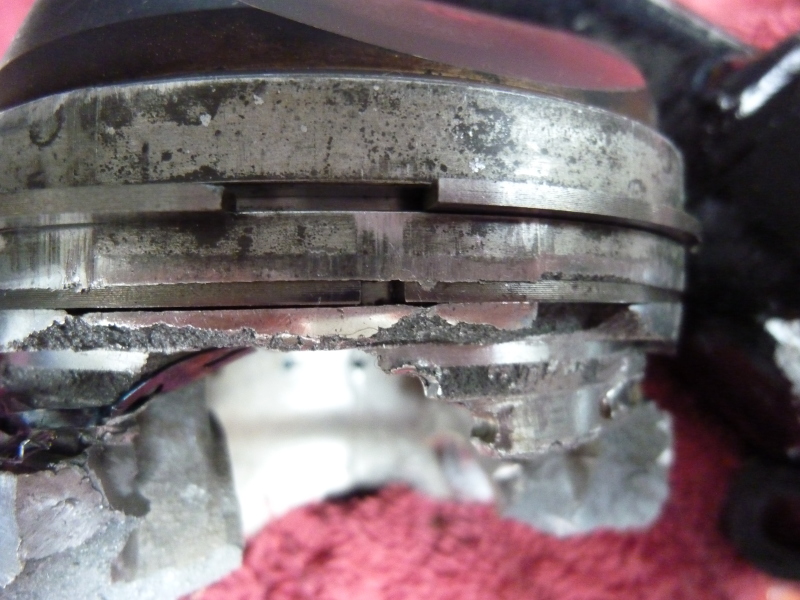

Alas cannot get close enough for the rings but no signs of touching neither top or second one.I chequed the gaps which were all within.009-.011"
which is right for 3" bore.I included foto's of the top and side of piston and of the block inside.
Bottom of side opposite of thrust is gone,nearly no marks on cylinder upwards.

Look at the wrist pin journal/hole on the left side of the piston. Why are there score marks worn in on the outer side of the left wrist pin circlip groove?
"Formal education is a weapon, whose effect depends on who holds it in his hands and at whom it is aimed." ~ Joseph Stalin
Lets say you made a mistake that lots of people make and either didnt seat the wrist pin circlip 100% properly, or you reused an old circlip, or just completely forgot it.
The wrist pin would float to the left side = flex a lot more because the other side isn't constraining flex like it should = leave scoring. Not only that, but it would fatigue the side that cant distribute the load throughout itself evenly because the pin is not riding completely in it. Once it has stress fractures, it will break on the part of the hole that has the least amount of material strengthening it. After that, the pin is going to violently destroy the other side and then smash a bunch of stuff.
Plausible?

gruntguru - What does it look like if no circlip is put in at all? I have never personally seen that mistake happen. But I have also never seen brand new factory spec bolts sheared off that bad, or a brand new piston completely grenade from an over rev. If this had happened because of such an extreme over rev, how do the other cylinders in the engine look? The wear marks on the wrist pin holes seem worthy of investigation, especially the one outboard of the circlip groove! Id be more apt to ignore those wear marks if they didn't happen on the most dramatic failure point. Those wear marks were caused by something

Looking at the piston rings,although they could have moved after the unfortunate event,as you may know already Dirk,piston ring gaps are positoned 120 degrees from each other
The position of the ring gaps means nothing. Rings rotate during engine operation at different rates.

to Panther 140:No marks from wrist pin on side of cyl.Other cylinders are perfect.

Looking at the piston underside I'd think this is also showing clear shear!I am not a specialist but the grainy structure shows it.

I looked over all of the (very nice) photos you provided of the failed piston, and I saw no indication of a shear-type failure. The only thing I could see in the photos seemed to indicate tensile type fractures that originated at the wrist pin bore edges.
Tbuelna,You are right:being a bloody foreigner,I meant tensile instead of shear...I still think the piston broke first as there is not so much damage to the fracture. The bottom half of the piston was smashed into smitheriens.It must have got blocked in the bottom part of the cylinder somehow to cause the rod to bend. Why the rod bolts broke then is still a question to me.
Dirk
I don't think it would be easy to bend a rod 90 deg like that without breaking the bolts.
