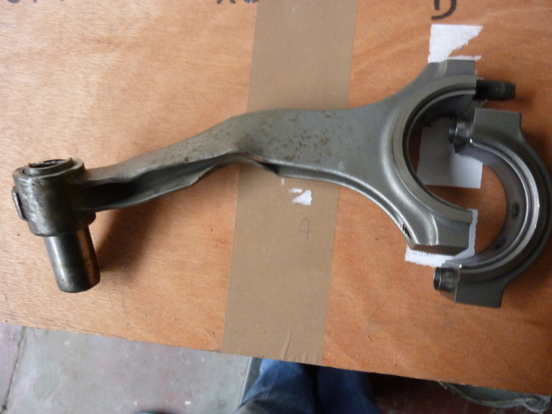

I reconditioned a friend's engine which broke later on during running in.The piston broke just on the pin line,conrod bolts snapped clean off, smashed the whole block.
My question is: is this always due to overreving or is there another possibility?

With the claim the retaining clips were in place and with the wrist pin not contacting the bore, it makes one wonder if the wrist pins were simply too short.
I went to my garage for another check on the block:there are no scratches or marks at all on the cyl. wall,exept honing marks.
As for the asymmetrical marks:the owner tried to restart the engine to see what was wrong;there was a lot of debris that could have been touching.Most of the bottom half of the piston was thrown out trough the big hole...Piston pin was OEM new,looks right length to me.
Dirk
have you contacted the piston manufacturer? Do any of the other pistons have wear marks in the writs pin bores even between the clips?
"Formal education is a weapon, whose effect depends on who holds it in his hands and at whom it is aimed." ~ Joseph Stalin
Piston is Hepolite,made in 1958 and NOS. Difficult to make a claim...
No marks on the other pin bores,I measured the bore with a tripod mike, no deviations,wrist pins are quite heavy,very little movement axially possible even without circlips.

have any of the other pistons been sent out to be analyzed? A brand new piston should not abruptly fail under any RPM that the engine can rev to on its own

Based on the amount of damage shown in the photos to the block/conrods/pistons/etc, I can't imagine the engine is worth salvaging, unless it is an extremely rare model. Fixing the massive hole in the side of the block would require extensive weld repair and re-machining of all close tolerance features. The picture of the block appears to show the cylinder bores have already been over-bored and sleeved. And given how badly the conrod was deformed, it seems likely the crankshaft was also bent out of shape.

Just wondering,as the rod is angled,and the piston broke first,whether there could not be shear implicated.
When the rod is blocked there would be side pressure on the cap lips as well.They are not designed to take those high loads and could move a bit sideways to create shear on the rod bolts.I will examine the cap's lips again.

i have experienced this problem. Root cause was casting sand which had congealed and remained in the piston internally. Worked loose and cause grinding effect on liner , eventually seizing piston on TDC and separating at gudgeon pin area.

If it was going to be hot rodded should have used some good forged pistons. Is that an inclusion right hand upper
wrist pin hole? I think it was a bad material-casting problem.

"The 55 lb/ft installation torque you note seems high for a 3/8-24 UNF bolt having 110 ksi UTS, especially if the threads were lubed at assy. You might want to do a quick calculation to check if the combined tension and torsion forces at installation would be enough to overstress these bolts. "
I put this torque (55 LBf-ft onto 3/8-24 stud/nut) in my thread stress software, inputting nut to base friction coef = .18, nut to stud threads coef = 0.18, (lubricated threads and nut seat)comes up with stud princ. stress = 136ksi! Not lubed, friction coef = 0.3, gives less than 100ksi stress.
To FredRosse:I mentioned 45 ,lubed as given by manufacturer of rods,and I think ARP as well.I have a racer with Cunningham rods,same spec.
Dirk
Your close up of the failed bolts clearly shows that one of them has the tell tale "beach marks" indicating that it failed over more than one cycle and not catastrophic like the other. That bolt fracture went catastrophic after about 3 cycles based on the beach marks and the other bolt is a pure catastrophic tension break, likely from the rod cap leveraging it in tension after the first bolt broke. The first bolt that broke also has a pulled thread and a slight lean opposite the failure origin (center OD of 1st beach mark) indicating that the cap was bending about the remaining bolt, causing the extreme tension that failed the second bolt catastrophically. BUT, pictures alone can be a bit deceptive.
